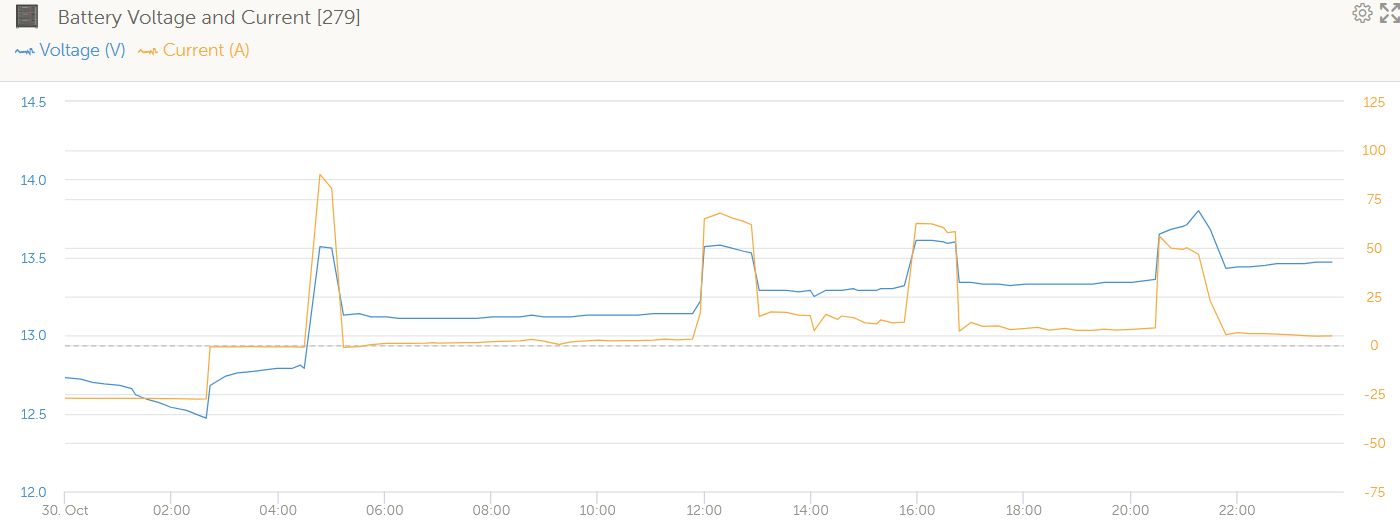

this is the graph of voltage and charge current.
@ 5am this was alternator as no shore power available
@ 1200, shore power enabled, charge current 65 amps for about 1 hour. SOC 50%.
@ 1600, i restarted VE Bus system, multiplus changed from float to absorption and current 65amps. again for about 1 hour. then dropped down to float and 10amps
@ 21:00 restarted VE bus and state changed to absorption, current 60amps for 1 hour before dropping down.
The Voltage at each of these periods is around 13.5 so well under Absorption setting in the Multiplus.
so it would look like the each period is 1 hour before changing to float and dropping to 10amps.
IS this anything to do with Multiplus Charger setting of Absorption time set to 1hr ?
You need to look at the voltage measured by the MultiPlus.
