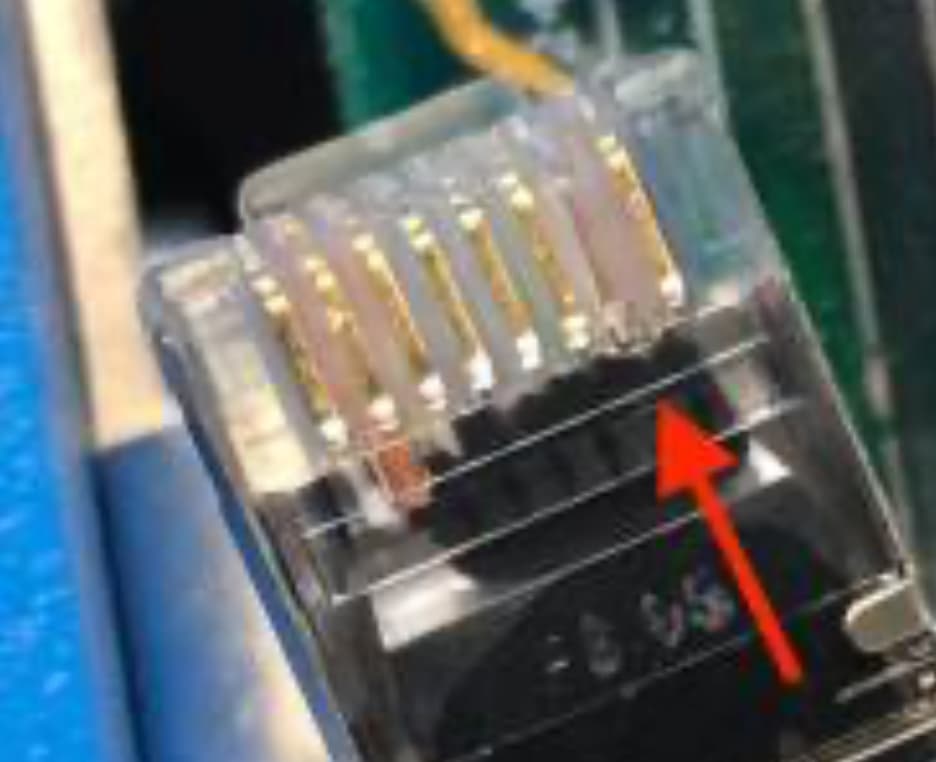

You don’t need to open the cable,
See in this photo how the gold pin contact at #7 is missing?
You can remove it with a small flat head screw driver. It comes out quite easily.
You can see some minor damage on the plastic part just below the pin groove, that was where the flat head was placed, and then some pressure applied to pry out the gold pin.
Ok Thanks
Hi Guy
With pin 7 disconnected, does this have any side effects?
Will the cerbo still communicate with the inverter?
Do I leave the cable with pin 7 disconnected as a permanent connection?
Thanks
