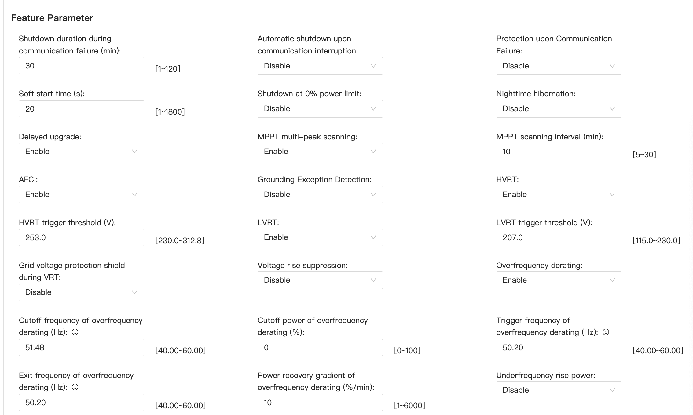

And these are the parameters i set in the Huawei fusion solar , via web configuration, in particular in section Feature parameters, enable frequency derating and set the cutoff power % in zero. 51.48 and 50.2 are set in this section

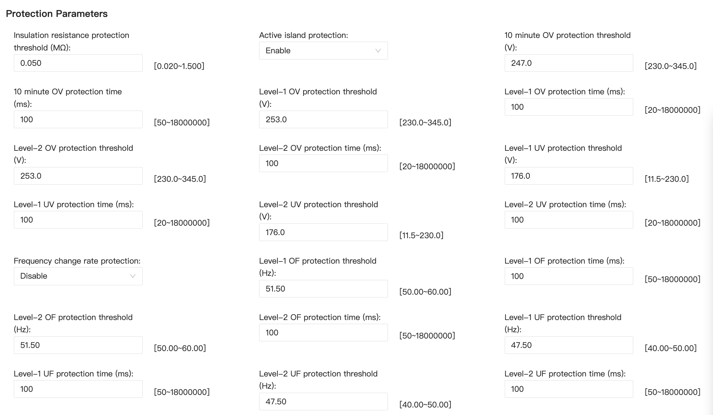

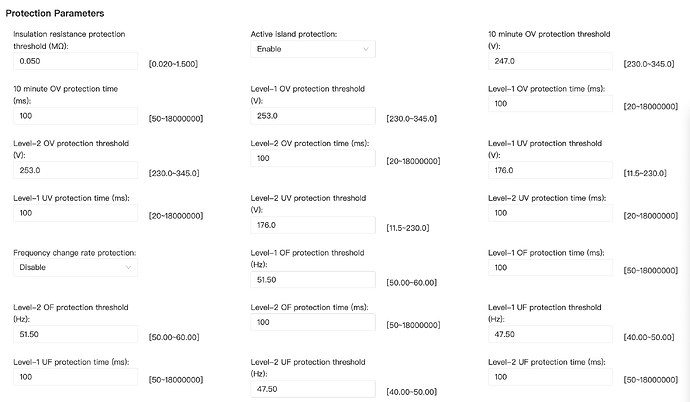

According to the grid code parameters (that i had to set manually) the disconnection 51.5 frequency is set in the protection parameters

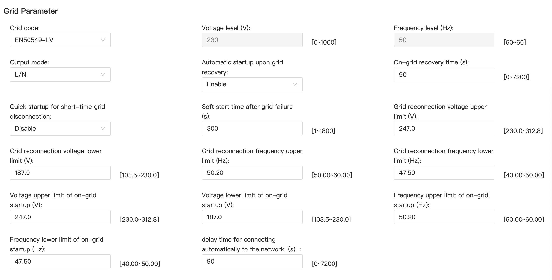

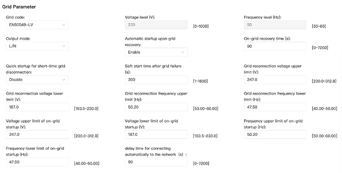

Other parameters and the grid code used can be seen here:

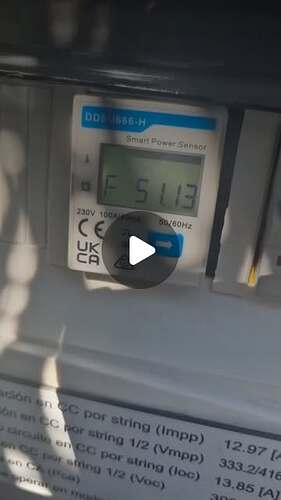

You can see how it works in this video:
