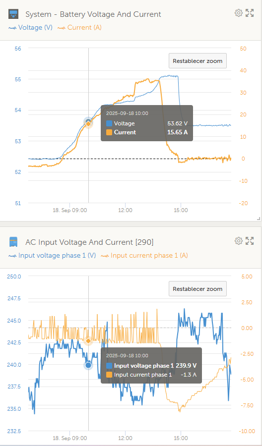

Here you have the day before yesterday graph. (I will put more graphs afterwards)
As you can see, the charge has been go on charging even above 53.6V

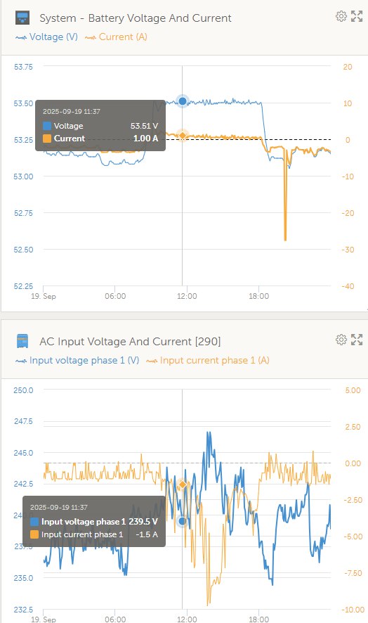

Here, yesterday graph:
Here, no problem, all day at 53.6v

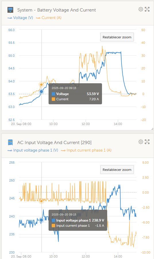

Here, today’s graph:
Again, MP2 is charging battery over 53.6v, up to 55.2v.
