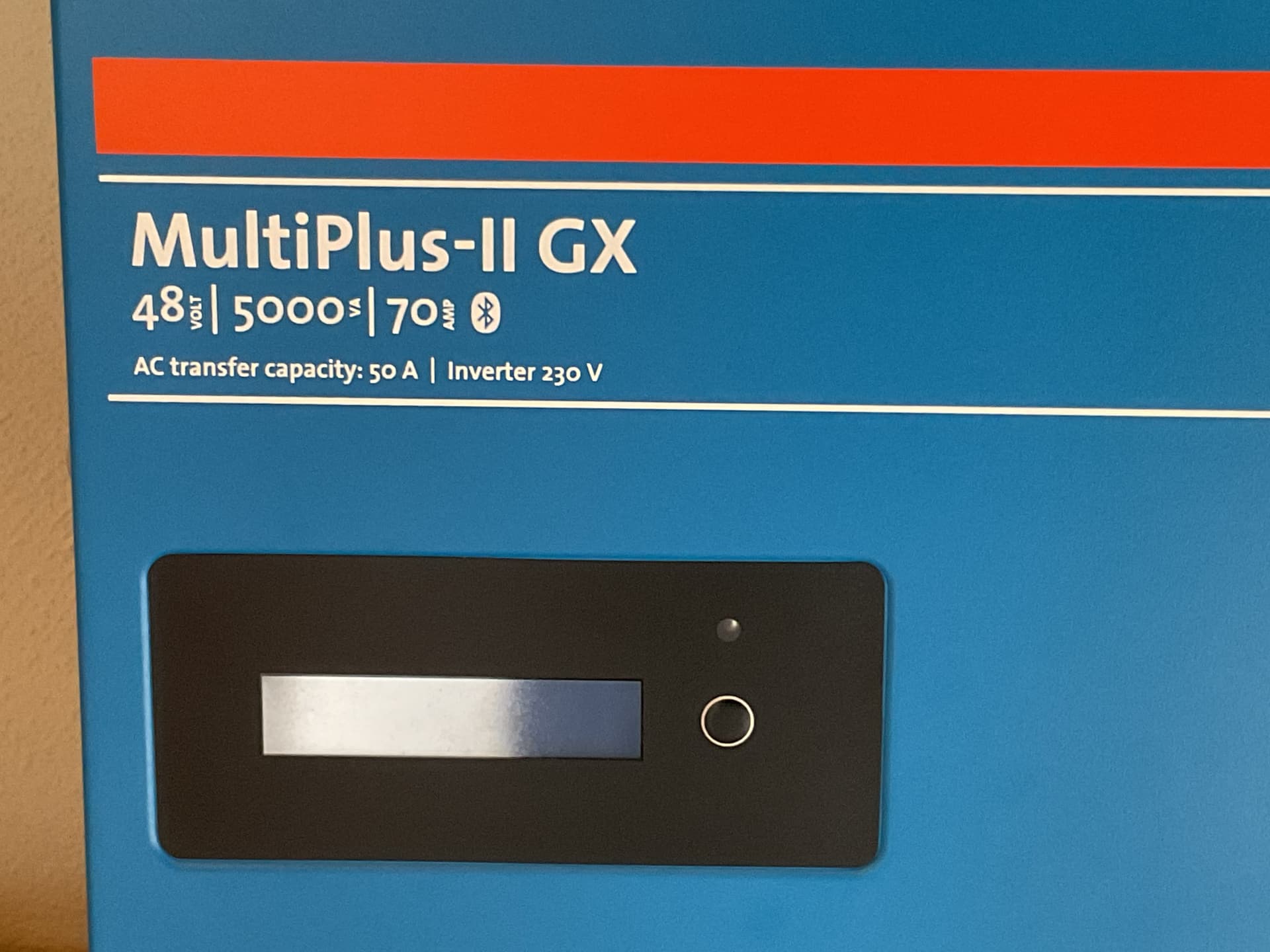

Dear All,

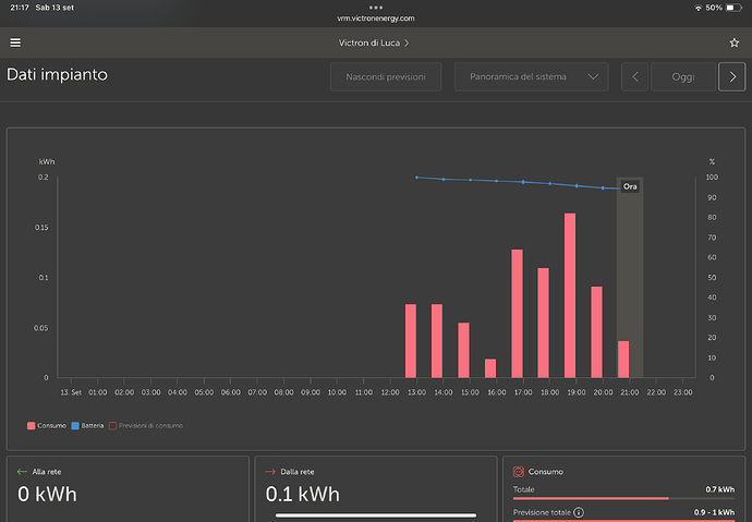

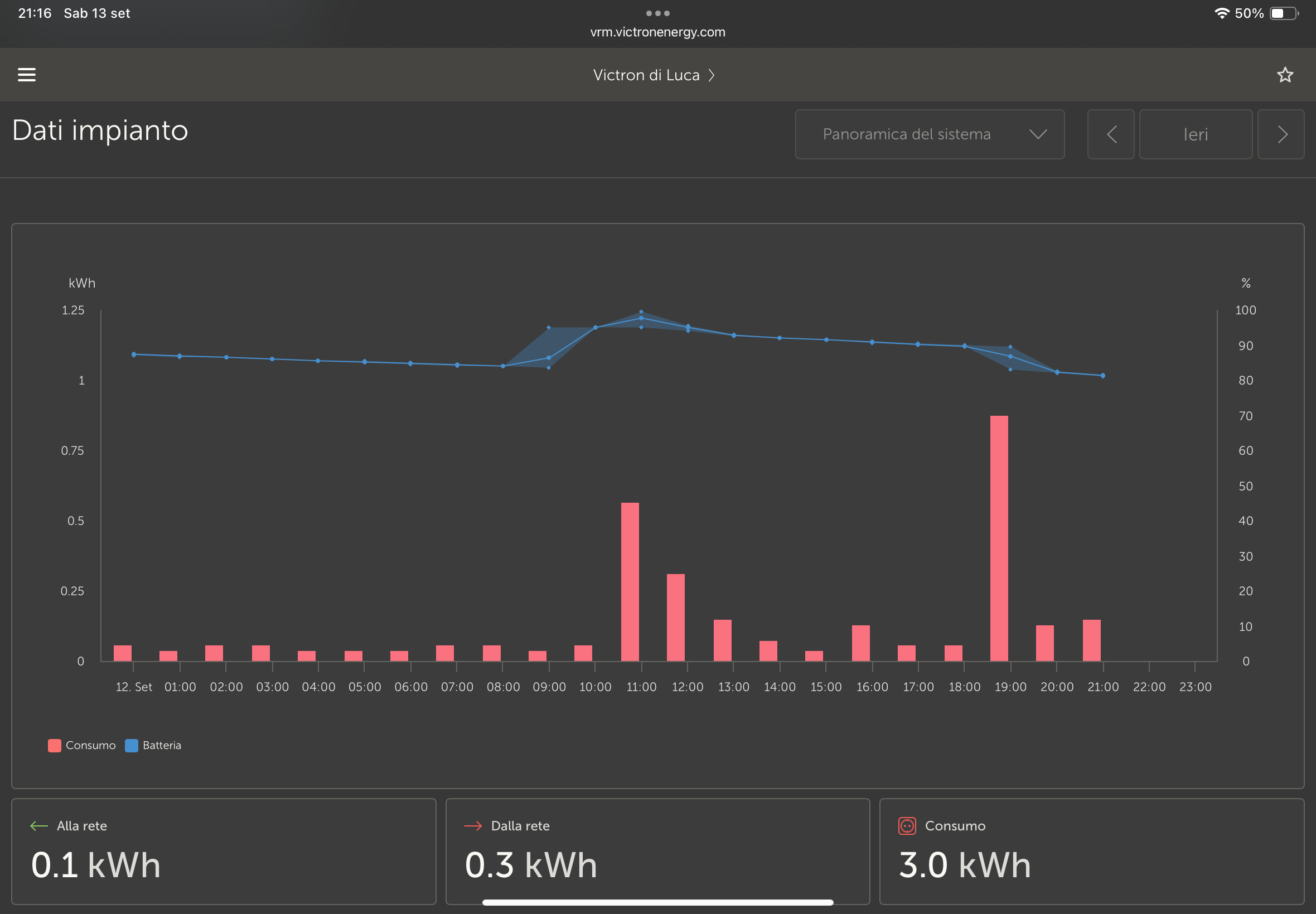

On Saturday 6 September 2025, I installed a Multiplus II GX 5000 in my PV system. I registered on the VRM Portal and set the parameters, including ESS. The inverter worked correctly for this week. This morning (13 September), I noticed that the inverter display was off, black, with no writing, and even pressing the button next to the display did not turn it back on (the AC power supply in the house was not interrupted). Looking at the router, I saw that data transmission to VRM portal had also been interrupted. Unexpectedly, in the early afternoon, the display turned back on and the inverter was connected to the VRM. At this point, I thought it was some kind of GX standby mode rather than a real fault. I asked a friend who owns a Multiplus II and he gave me two pieces of advice: 1) I set the “keep screen always on” option to ON in VictronConnect connected via Bluetooth, 2) I connected a USB key with a small LED that flashes every few seconds to the Victron USB port to increase the current consumption of the GX system. Do you think it could be a fault or did I set some parameter incorrectly that causes the GX to switch off?

My PV system has been in operation for three years and the battery is always full and working properly. I only replaced the old inverter with the new Multiplus II GX 5000 a week ago. As you can see from the VRM, there is a 16-hour gap between last night and this morning. As I wrote, the AC supply was never interrupted. So the problem is with the GX, not the inverter or the battery.

If the internet connection is down, the data is temporarily stored until the internet is back up, so there should not have been any gaps.
