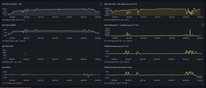

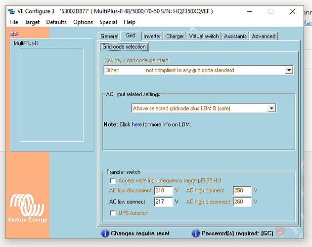

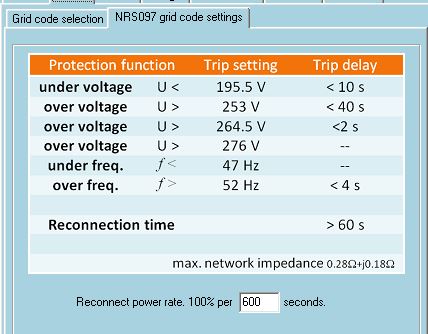

Latest “Overload Event” I noticed a voltage drop to ±220VAC and a spike to 55Hz. According to the grid code settings the inverter should diconnect from grid at 42Hz (but with a trip delay of 4s)

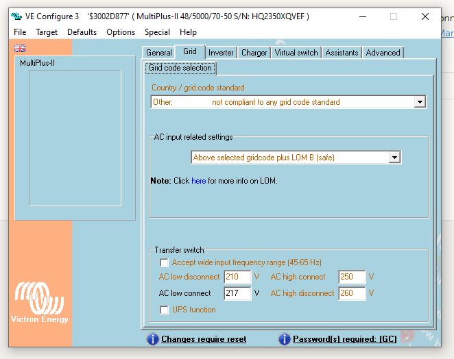

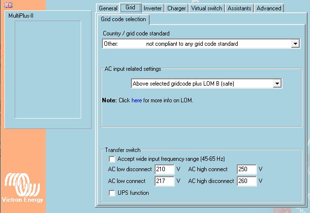

Changed this now to, non compliant:

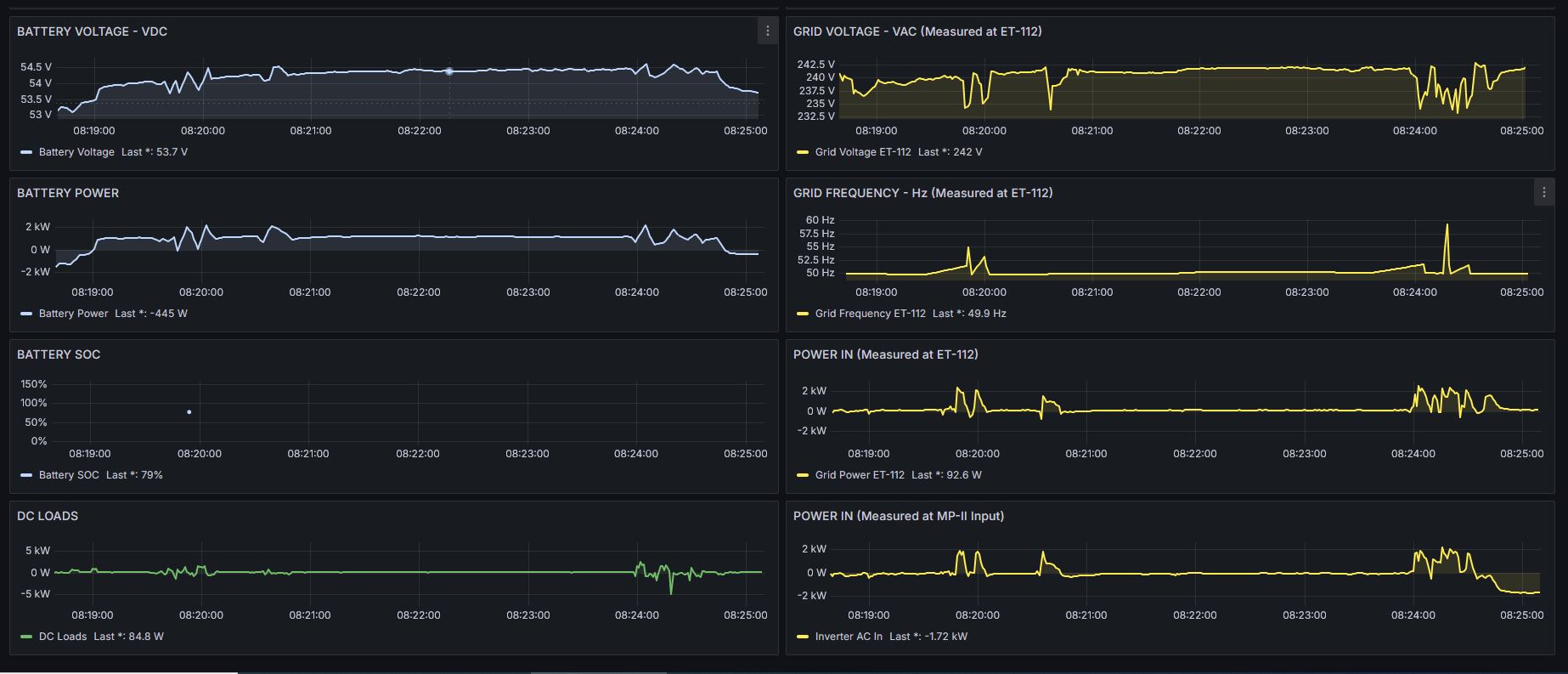

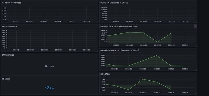

The actual event:
Looking at the battery power dip at the same time as the “Overload Warning” I would assume that the inverter did reject or tried to compensate for the grid at this point and tried to drive some of the load from the batteries / PV.

My opinion / theory at this point based on the following:
I) 08:53:22 DC Load surge -2KW
08:53:23 DC Load shifts high 2KW
II) 08:53:22 AC Frequency starts rising
08:53:24 AC frequency peaks at 55Hz
III) 08:53:24 AC Voltage drops from 240VAC to 230VAC
  • MP-II DC power generation spikes by 4KW (Higher than needed generation)
    which causes:
  • Frequency shifts high (effect of much higher supply than demand)
    which causes:
  • MP-II rejects grid hence AC voltage drops from 240VAC to 230VAC (Grid = 240VAC / MP-II = 230VAC)
I believe the MP-II makes a calculation error at some point (hence the out of wack calculation on Cerbo every time there is an Overload Warning). I believe this behaviour to be caused by the high impedance supply cable.
Any one better educated than me, please give your opinions or corrections?

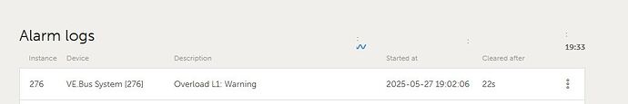

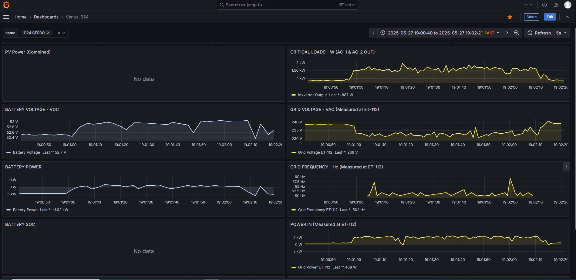

First ever Overload Warning at night. In ESS:
  • BATTERY 56% (ESS min SOC 20%)
  • 19:01:01 Installation switches from BATTERY to GRID power (runs all loads from grid)
  • 19:01:04 Installation state changes from “DISCHARGING” to “EXTERNAL CONTROL”
  • 19:01:04 Frequency shift to 57Hz (this is one hell of a coincidence)
  • UP TO 19:02:06 a back and forth between “DISCHARGING” and 'EXTERNAL CONTROL"
  • 19:02:06 “OVERLOAD WARNING EVENT” frequency shift to 60Hz
Grid code settings:
It seems like the installation connected to grid rather than diconnect as per the grid code settings in Ve Configure (why, unless the installation caused the instabillity)? Extremely odd behaviour?

Sunday morning, no overload. crazy noises from inverter, frequency shifts and back to normal. As can be seen in the graph the grid is usually very stable at +/- 0.2MHz shift max.
And again, the graphs just below FREQUENCY , Power in ET112 and Power in MP II (this is no miss read or calculation issue as these are 2 different calculations from 2 different sources) show that at the time of the frequency anomaly the inverter switches back to grid. It is supposed to disconnect from grid due to the high frequency (if it is the grid causing the issue???). Would love to hear from Victron, but unfortunately that avenue of support is non existant.
