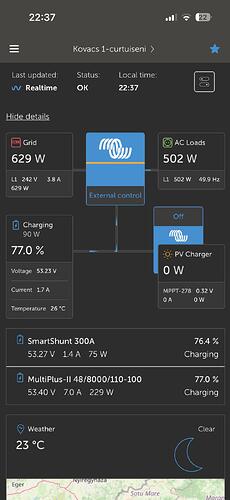

I have a Victron MultiPlus-II 48/8000 with Dyness batteries. My problem is that the inverter seems to prefer grid power instead of inverting:
  • It switches to grid for about 1 minute,
  • Then back to inverting for about 30 seconds,
  • Then back again to grid,
  • This cycle repeats constantly.
During each switchover there is also a humming/buzzing noise, which is especially disturbing in the middle of the night.
To stop the noise I have to manually disconnect the grid.

Screen shots of what the system voltage / load ect at time of issue would maybe help.
