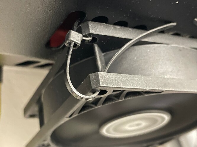

My 3D printer is broken, so I zip tied the Artic fans to the metal. Each fa with two zips only. Workaround us working great :wink:

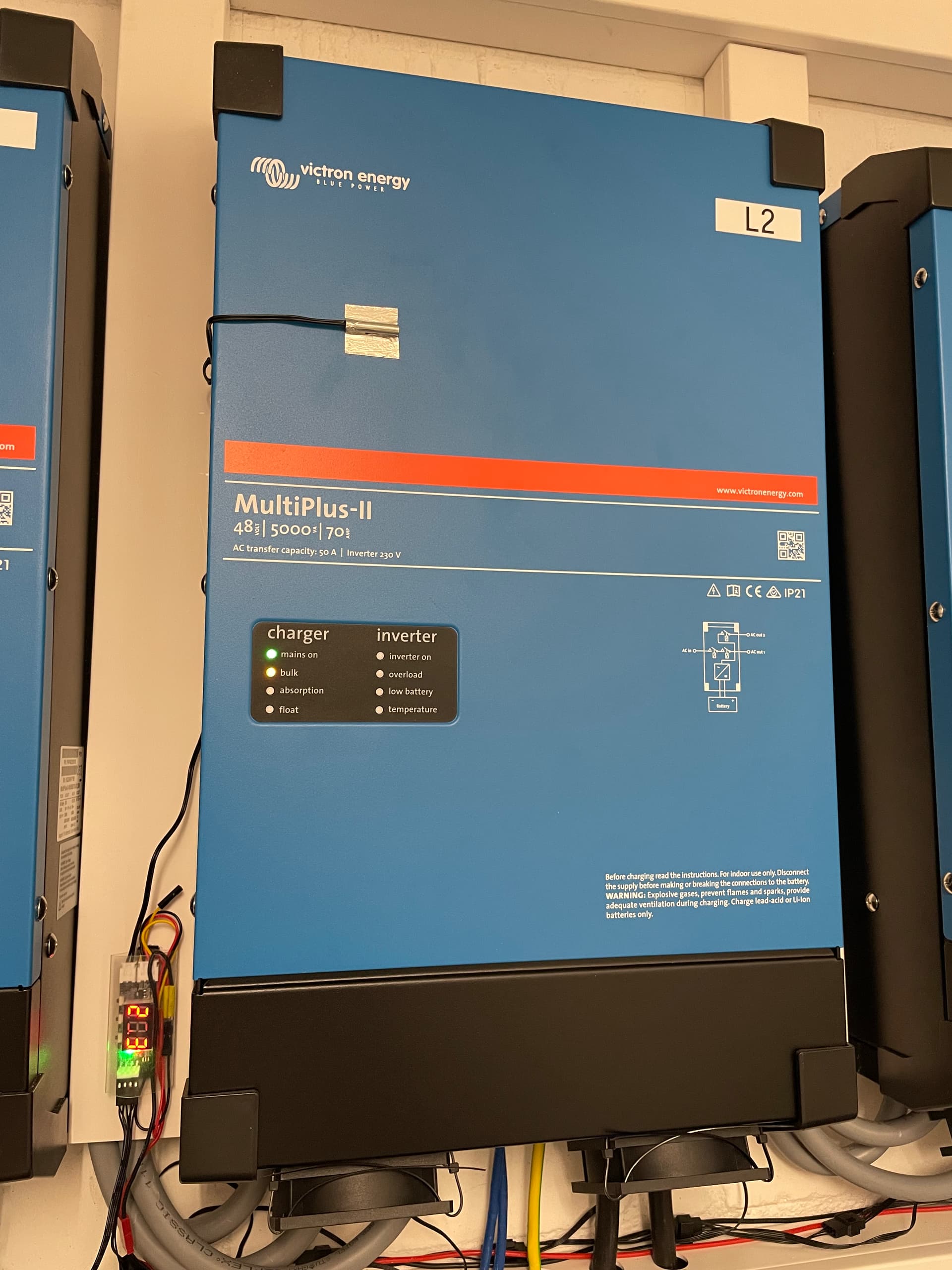

I use PWM fans with a cheep temperature fan controller for 4-wireIintel protocol. The temperature sensor is put on the blue cover with alloy tape.
Really cool! Could you show a bit more in detail how you power it and where? Thanks!
