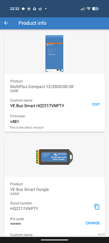

Below is a screenshot of the inverter showing up to date firmware together with model

If you recently updateded the firmware the charger will be disabled. You need a VE.Bus MK3 USB cable to download the config file and adjust the settings with veconfig. I dont think you can do that with the dongle. Do you have VRM, gx device or anything like that?

Unless the firmware has updated in the background I haven’t performed a firmware update.
