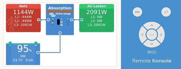

No, not working.
I can charge Pytes, now 2nd LED flashing and voltage approx. 53 V, but V
MP2 doesn’t display Pytes BMS: Setting
Searching now for a good idea ?
