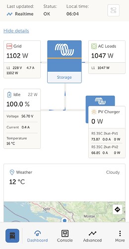

Does anybody have in VRM something like this:
Q: Systems based on Multi RS (!)
AC Loads and Critical Loads in VRM -
How to make it always visible?
If I turning on Multi RS, VRM hiding block “Critical Loads” (Essential Loads) immediately.
I read all the topics like “VRM and Critical Loads”, but none of this works for the Multi RS Solar…
Thx!
Hi @Andrija . Looking at your screen grab, Do you have a settings reason why the battery is not discharging to satisfy your load?
Hi David, thanks for your attention, it is because “keep battery charged” option enabled and Multi RS turned off, It is not a problem.
My problem is:
I believe it’s a misrepresentation from VRM part in case of Multi RS.
The inverter output (ACOUT1) is off when the inverter is off.
The other output (ACOUT2) is just a plain mirror of ACIN.
So, in a way, ACOUT1 can be considered an output for critical loads.

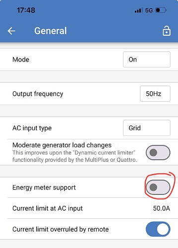

Problem was here:
If external meter connected to Cerbo GX (not directly to Multi RS), this option must be OFF.
ACOUT1 used for essential loads
ACIN used for nonessential loads
ET112 used as Grid meter
Now all systems working perfectly!
