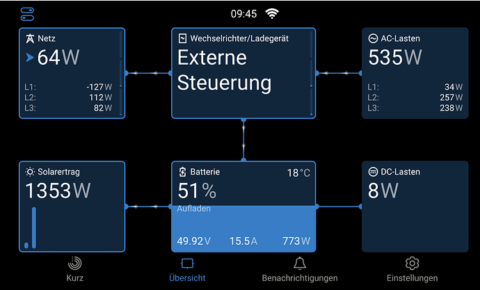

Got a problem:
For several days now, the yield has been very low due to a lack of sunlight, and the battery charge has fallen below the set SOC.
Now, when there is sunlight, the solar output seems to be throttled. The smaller comparison system delivers more power than the system in question here.

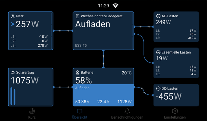

SOC = 15%, the “active SOC limit” is displayed as 80%. Why is the battery (charged at 58% capacity) load completely by PV, and why is the consumption current drawn directly from the grid rather than from the battery and/or solar power?
Any ideas as to why this is the case, or instructions on how to determine the cause?
Latest status: Now active SOC-Limit reads 75%.
