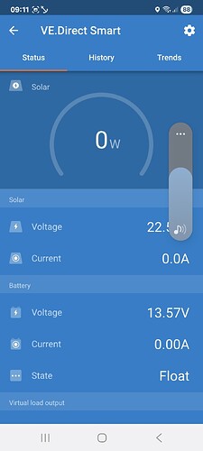

Your symptoms are unusual and I am out of ideas especially as you have changed everything. You could capture screenshots of your mppt settings and the mppt status page, that might give a clue, but Internet diagnosis is hard for unusual cases.

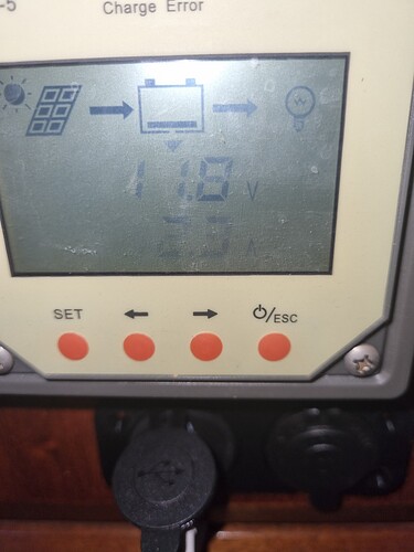

Thanks very much for your help, now thinking about it the fuse going is misleading I will send some screen shots. Hope i got the right picture but you can see that the mppt is either in absorption or float and my batteries are showing 11.6v
