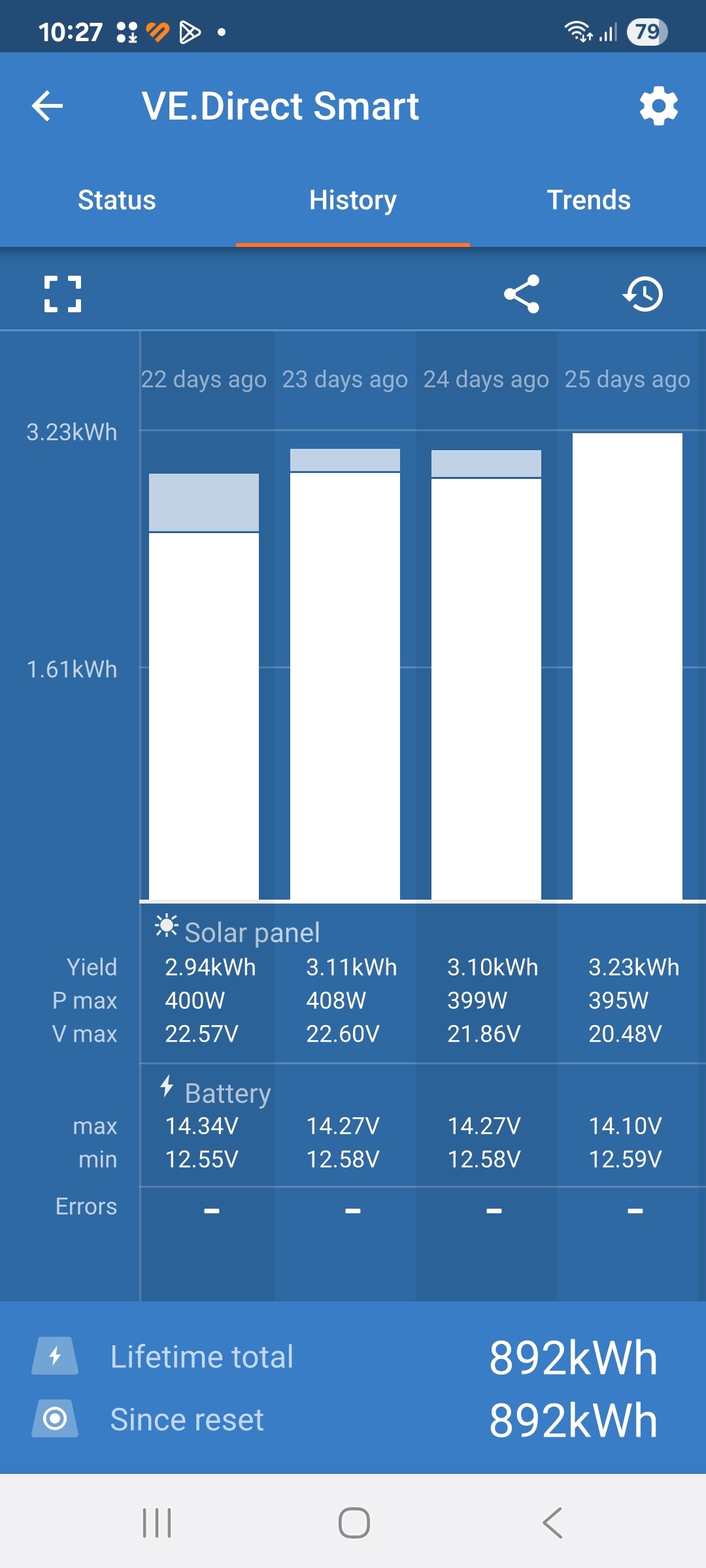

On my mppt during the day it will over read by about 6 volts and at nights time it will read zero volts. I have changed the MPPT, I have renewed the wiring from the MPPT to the battery, I have renewed the fuse and I have also renewed the battery. I have taken all other connections off the battery so just my MPPT is connected. I have tried everything even all the cabling from the solar panels. Any ideas I would be so grateful. The first picture is now and as you can see although the battery never went below 13 volts you can see at night it went to zero volts and as soon as there is any sun on the solar it jumps up to the correct voltage or just above. The second picture is from a few weeks ago when everything was fine.

Thanks for your reply, my solar panels are just over 9 amps each, the reason they are in parallel because they are different sizes. The last couple of nights they have shown the correct voltage all through the night. So today I have rewired the MPPT back to the battery, fitting all new cable lugs, fitting new busbars and new fuses, I also fitted a victron battery sence. Before I set up the battery sence the mppt was over reading about .5v, I then set up the battery sence and bingo the battery, the mppt, the dc to dc and the battery sence all had the same voltage, then my battery went into Float mode and the battery and battery sence were reading different to the mppt and dc to dc.
I will monitor them and see what’s happening, this fault.did happen overnight, for 4 years everything was perfect.
