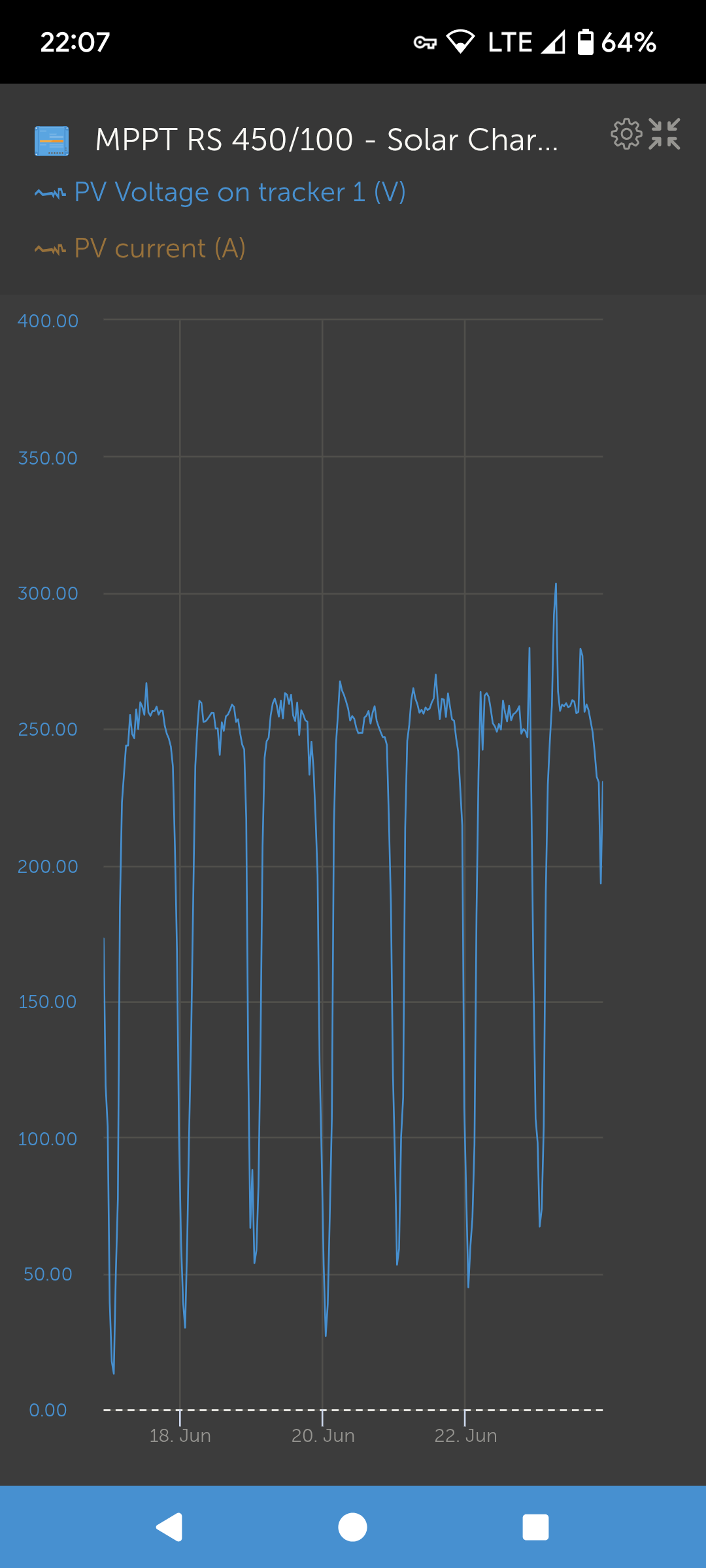

My Cerbo has the correct time. I wouldn’t have a problem with the MPPT deciding on its own when the day ends if it would you know, work. PV voltage drops to as low as 25 volts but it still waits until 16:15 (the time I booted the unit for the first time) to change the day.
All in all this means I have two days of history on my GX device, neither of whicg makes any sense since they’re calculated from 16:15 to 16:15…
