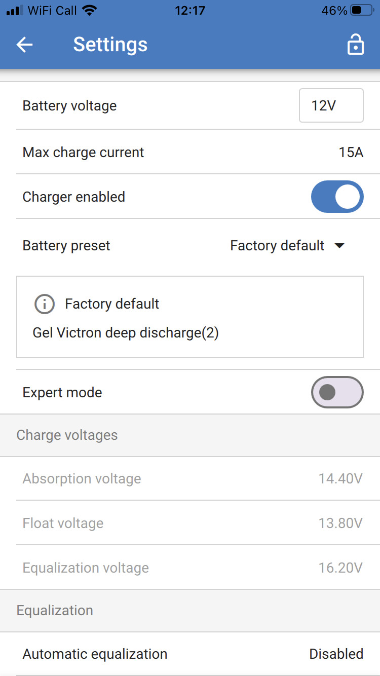

Please post the settings from the app, press the cogwheel for that
Hi I pressed the cogwheel then which one do you need me to post battery, load output, streetlight,TX PORT FUNCTION, rx port function, or VE smart networking
post battery settings please. Also any history.
Are you using the load output to run the fridge? If so, then connect the fridge directly to the battery. The load outputs dont like inrush currents. I cant run my compressor freezer rated at 4A on the 15A load output for example
Yes I assume I’m running it though the load output
Maybe I’ll try your idea thank you
