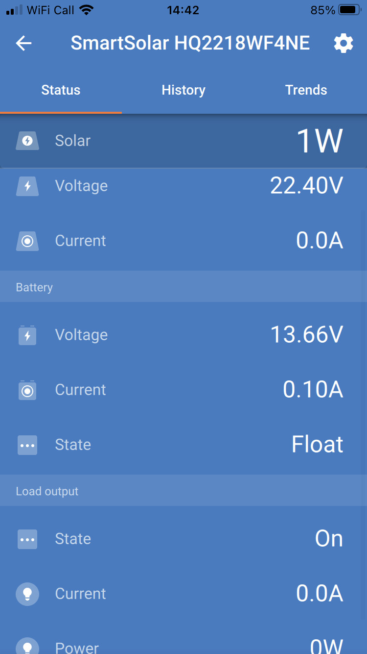

I have a 110ah leisure battery when I have my fridge on, the mppt stops working over night the only way I can get it working again is to reset to factory settings
Are you sure your PV voltage is reaching the battery voltage + ~6V threshold to start?
If there is sufficient PV and it is configured correctly, it should just carry on. Regardless, with a battery connection it should always be accessible, so you should be able to pull charts that show what voltages it is seeing, so perhaps paste those here, along with your settings.
Hi nick
Sorry for the delay in getting back to you I’m not sure what the pv settings or screen is
