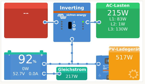

The input is seen on the Main system just fine. Here is a screenshot from the Cerbo:
Further, VeConfigure shows “zero seconds left” for the Mains connection. But: that never ends.
When forcing “AC Input Ignored” to false with NodeRed/VEBus, it immediately jumps back to the Ignored-state.
During the short time, when AC Input is not ignored, it is also shown in the overview:
But then falls back to no connection:
