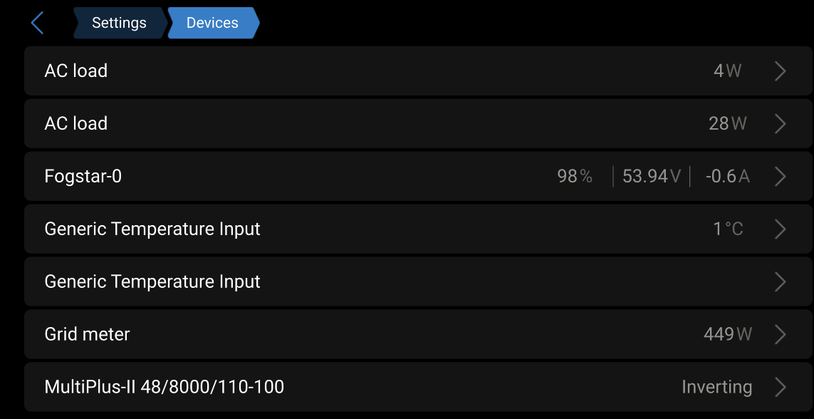

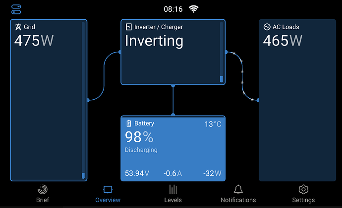

My ESS has been working flawlessly for months, however, today it’s no longer balancing the grid.
Grid input is still there, but the MP-II is not inverting at the correct level.
I’ve been through all the settings and can’t see anything wrong. I’ve tried re-detecting the VE.Bus system and restarting the VE.Bus.
Is there anything else I can check? Is there any more information that would be helpful to diagnose
Turns out this was as simple as a tripped circuit breaker on the AC Input
