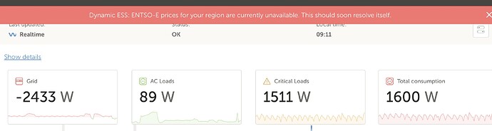

Missing tomorrows prices and they will be high for some hours. Anyone else with the same problem? This is for Norway.
I have another (new) one:
VRM shows an alert “Dynamic ESS: ENTSO-E-Preise für diese Gebotszone sind derzeit nicht verfügbar. Das sollte sich bald ändern.”
Prices are available though and DESS seems to operate normaly.
Best regards, Jochen
Same info today, but as it says, DESS looks to work as it should despite no prices shown.
Same here in The Netherlands. Prices are available for today, so why the warning?
Hi @Pim57 , good point! The banner checks if ENTSO-E prices are in: they aren’t, but in the meantime we do get the prices from an alternative source.
What we’ll do today or tomorrow is making sure the banner only shows when prices are in not available at all.
