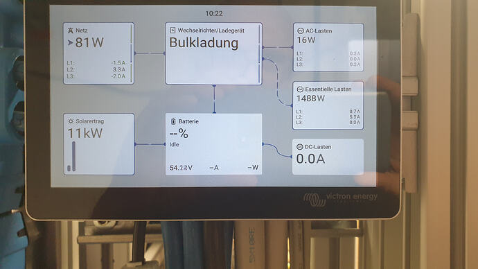

I’ve suddenly stopped receiving any readings from the Lynx Shunt 1000. Only the charging voltage is displayed now.
The only thing shown is the word “idle” and the current charging voltage.
I disconnected the Cerbo GX from the power supply and restarted it, but that didn’t help.
The green LED on the Lynx 1000 is lit.
The charging voltage is showing 54.22 V and the charging power is approx. 11 kW, but the charging current and SOC are no longer displayed.
Can anyone give me a tip on what I can do?
Hello Victron community,
The Lync Shunt 1000 started working again after I disconnected the power from the board at the shunt. Afterwards, the shunt re-registered on the CAN bus, but it still wasn’t displaying the SOC.
I waited until the charging voltage reached 56 V and then manually synchronised it to 100%.
Everything is working again now.
