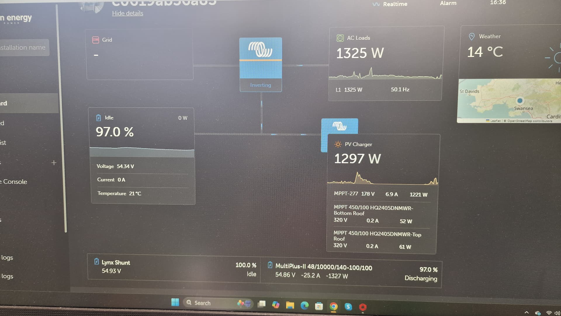

Today was a nice sunny day and I kept an eye on the VRM all day and noticed that for some reason the battery bank only now charges to 97% and then becomes idle, while the mppts supply the loads, and at many occasions my mppt 450/100 states 0w on both strings, even though the sun is shining directly onto them. What would the system suddenly behave this way, ot has been charging to 100% all through the summer and heating the water at 98%soc, but now its not charging over 97%.

Today, it’s stopping charging at 96%, not sure what’s going on as the system always used to charge upto 99% and on occasions I even saw 100%.
I do have a lynx smart shunt, but im not using it, it’s merely just an expensive fuse holder as the batteries bms’s are controlling the soc percentage.
I have 8x 7kwh Rahvolt batteries in parallel with a 3 wire data cable daisy chained between them and connected to the cerbo gx.
Today both mppt’s were charging, pushing 3kw into the batteries until it reached 96%soc , which has now caused the battery bank to go in idle state and the mppt 450/100 to stop outputting.
I have not altered any settings, the system has worked for months going up to 100%soc, but as of a few days ago it never reached above 97% and today 96%
