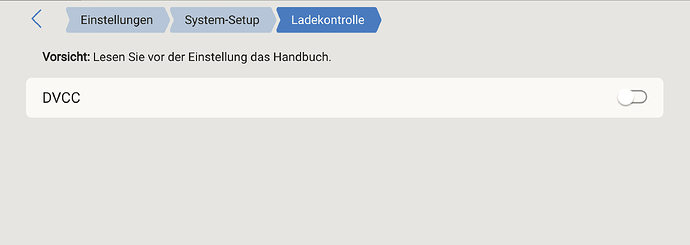

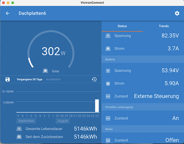

I have a 3-phase system with three MultiPlus 8000s. My three charge controllers are connected to the Cerbo GX via VE.Direct. Now, here’s my problem: I can’t adjust the voltage on my charge controllers because “External control” is displayed. This isn’t a problem with my 450/200, where I can adjust the voltage; it is connected via CAN bus.
Could you please help me with this? I’d like to set a slightly lower voltage for the summer, but at the moment I have to switch off my three charge controllers that are connected via VE.Direct.

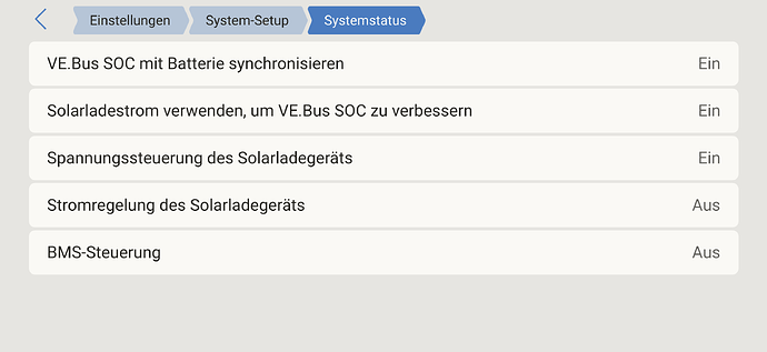

External control will happen when DVCC is enabled, does not require a managed battery - in this instance the inverter/charger’s algorithm is used not the mppt’s internal one.
With a managed battery it is still external control but managed by the BMS, the inverter/charger settings are ignored.

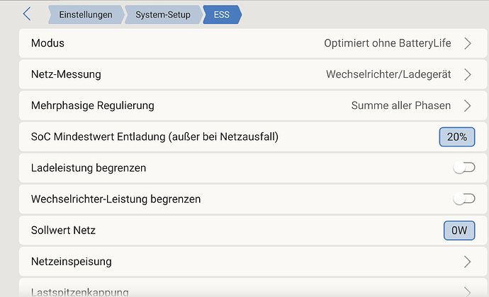

However, I noticed that I have an ESS installed, which I don’t actually need, do I!?
I don’t want to keep the batteries charged to 100% all the time; in summer, I only want to charge them to 80%. But I can’t seem to adjust these three charge controllers, and if it is possible, I don’t know where.
