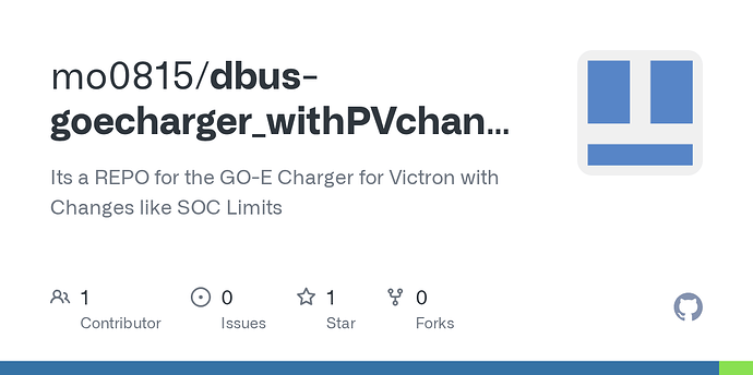

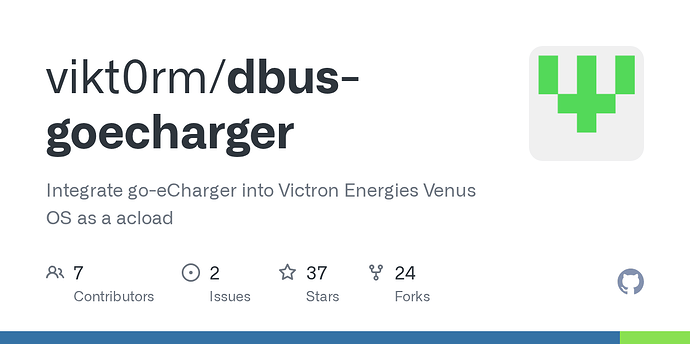

Not out of the box, at least, but perhaps you can make use of this:

Give it a try, and if it doesn’t work, I might need the log. I might be able to build something for you — it depends on how similar the APIs are.
