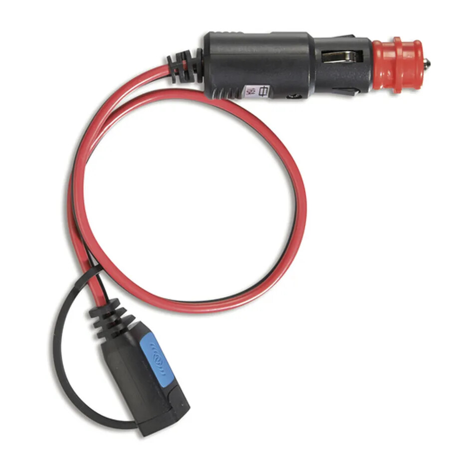

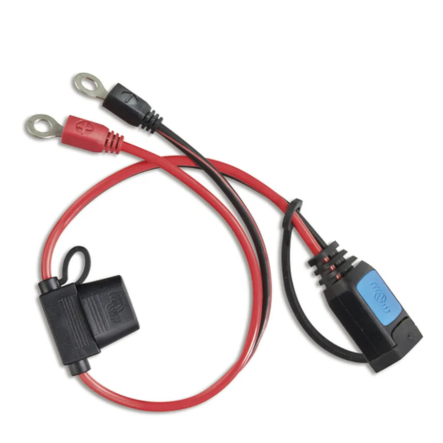

Can I use the Blue Smart IP65 Charger 12/15 via the Victron Blue Power Smart Charger Accessories - 12V cigarette plug connector or M6 Eyelet Connector?

@4l3x69 If you charge via the accessory port, you need a canbus charger e.g. an optimate 4 canbus edition, which is compatible with BMW motorcycles and what I use. Victron chargers do not have this functionality. You can probably use it if you wire it directly to the battery, but not nearly as tidy or convenient as the accessory port option.
Thank you for your reply.
That’s what I thought, that purchasing an additional Optimate 4 Quad charger for the Li-ion battery in my BMW motorcycle would be unavoidable.
