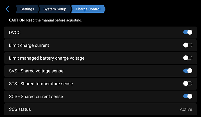

You can do it in DVCC if I understand your need correctly.
@ejrossouw
Thanks but my understanding is that setting is for a “A configurable system-wide charge current limit…”.
I need to limit JUST the Multiplus II charger so as to limit the draw on AC from time to time.

You can change it with veconfigure or victron connect, but only the grid limit is configurable from the GX.
Yes, that is the point of my post!
To be able to change the charge current limit from the GX device - Ekrano in my case.
At the moment I have to disconnect/shutdown the Ekrano then connect a Victron Connect app capable device (laptop in my case) and make the charge current limit change then restart the Ekrano. As opposed to the user friendly way of changing the AC input limit current in the Ekrano.
The point of my post here is requesting an easier way to change charge current using the Ekrano and hope the Victron engineers get the opportunity to add the feature. :slight_smile:
