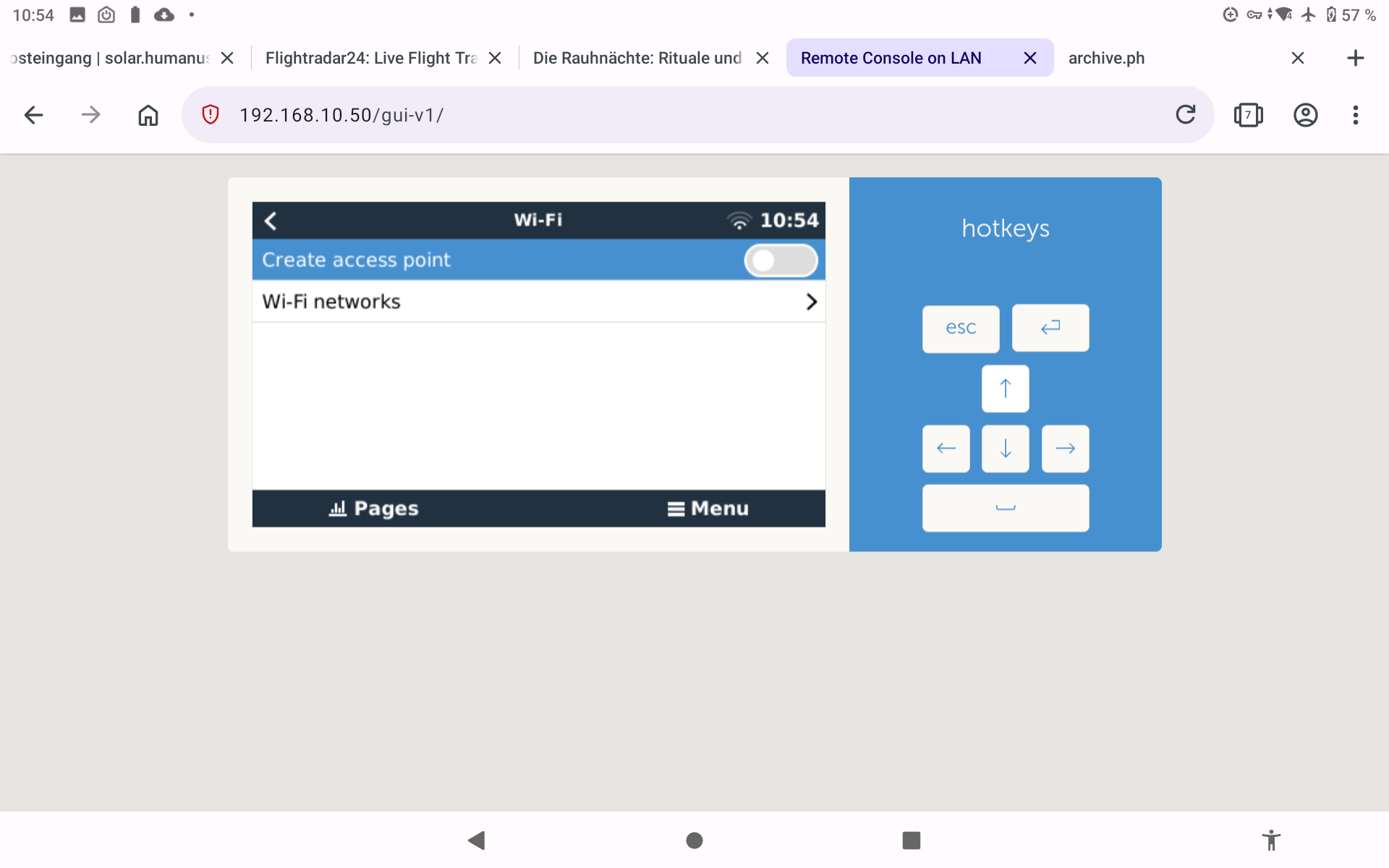

Why don’t you show the menu when you have deactivated WI-FI … then you won’t be providing an access point
Thank you for your reply Steffen. I’ve done some more screen-shoots. The GX Model is actually still connected via WLAN.

Edit the WLAN Access Point and remove the connection settings… It will stop connecting.
