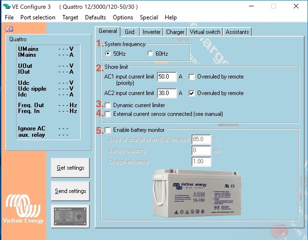

You can not set charged voltage with Venus OS. To set the inverter you use a Smartphone using VictronConnect and the Mk3 USB or a PC/!aptop and VE Configure and adjust the general page / settings. A Smartshunt would give best accuracy. You can even do this through VRM with VEConfigure and a pc/laptop.
VE Configure had no working settings
adjusting the charge voltages did not adjust what the SOC would call 100%

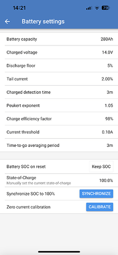

You say you have a 48V system but the screenshot of the settings from the BMV/SmartShunt shows a “charged voltage” of 14V.
That causes the SOC to jump to 100% too early.
14V ? where can I find that setting to change , does that mean its thinking its a single 12V battery and not 4x or did you /56 = 14v

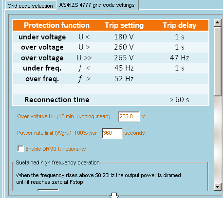

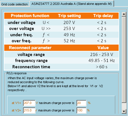

also open to idea’s why it will disconnect from grid when using 2020 vs 2015 settings
grids voltage and hz are within spec 240v-250v / 255v 50.1~50.4
I am leaning towards because 2020 has got 50.25hz output power is dimmed …
grids normally 50.1hz and 2020 can not take a small 50.4hz bump ?
In your first post you have added a screenshot from the settings of your BMV/SmartShunt.
Edit: You don’t have a BMV/SmartShunt? You should buy one, the SOC calculation of the MultiPlus can only see the current going through itself, other loads/chargers can’t be included in the calculation.
oh that was someone elses screenshot that showed their SOC settings that I do not have on the multiplus 2

The Multiplus has a simpler battery.monitor and the only settings ate explained in the link I gave you to start with.
However, this only works if this is the only inverter. If you have other inverters running off the batteries, hpw can the Multiplus know anything. Victron battery monitors do not work by a voktage to SOC curve, tjey work by counting the energy (add up current x time) flowing into and out of the battery so a Victron battery monitor has to be connected to the battery and all charge sources and loads flow though it.
