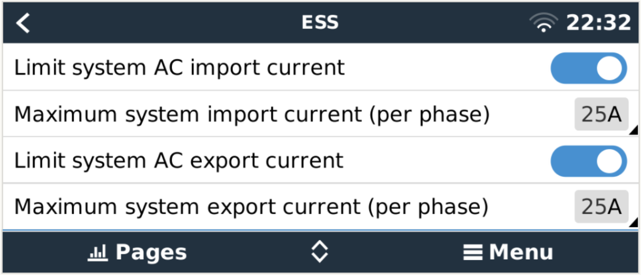

Have a look at this:
in particular, peak shaving which is the technical description of what you are trying to achieve.

I’m having some trouble configuring it.
I have a 3-phase net, but a single-phase battery inverter.
I have set the Multiphase regulation to “Total of all Phases”
The peak-shaving setting, is per phase. does this mean I need to take in account the singlephase from the inverter or the 3 phase from my net.
I would like to limit the total grid import to 6 kW,
Is this then 26A x 230V = 6K
or **9A ** x 3 x 230 V = 6K
Thanks
Frank
