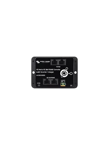

As my device has a 17… firmware (which you can see on the lengthy chip on the first photo), it is not compatible. The solution is to buy a VE.Net to VE. Bus converter.
Product description:
Here
Quite expensive. ![]()
Here for half the price Victron VE.Net to VE.Bus Converter — Trans Marine Pro & Solar Solutions Northland
