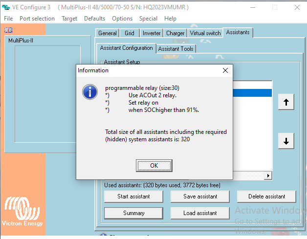

Looking to tackle this from a possibly more simple angle: Is it possible that the ‘AC2 relay off’ function I require is not working due to the order that the Assistants are set-up in VEconfigure? Could the Assistants corresponding to the battery SOC be permanently overriding the one for AC load?

I take it you have created an assistant that does this?!
Can you show the summary of the other 2 assistants you have?
I think I know what is casing the issue you are experiencing now.
Yes and no, in the strictest sense.
Combining multiple Assistants

Assistants in the following order:
  1. AC2 off when load above 3500W
  2. AC2 on when SOC above 90%
  3. AC2 off when SOC below 80%
So this is not my forte, but I think in your case:
1.) OK
2.) Becomes 3.)
3.) Becomes 2.)
BUT if the SOC is over 90% and a high load event occurs the ‘ON’ assistant will take priority and continue in the ON state.
At 90% 3.) is not true (but if on, relay AC OUT-2 remains on)
At 90% 2.) is not true (but if on, relay AC OUT-2 remains on)
At =<%90 AND load > 3500w >3s 1 is true, 2 is false, 3 is false, if on, relay AC OUT-2 turns off
At >=%90 AND load > 3500w >3s 1 is true (an OFF condition), 2 is true (an ON condition), 3 is false, if on, relay AC OUT-2 remains on as the ON condition takes precedent.
That’s easy enough to test.
So maybe you might be better using the primary relay to disconnect the load via a slave relay / contactor with 1.) So the AC OUT-2 is on SoC >= 80%, but the primary relay would disconnect the load via a slave relay/contactor when the load > 3500w > 3s, regardless if SoC > 90%
