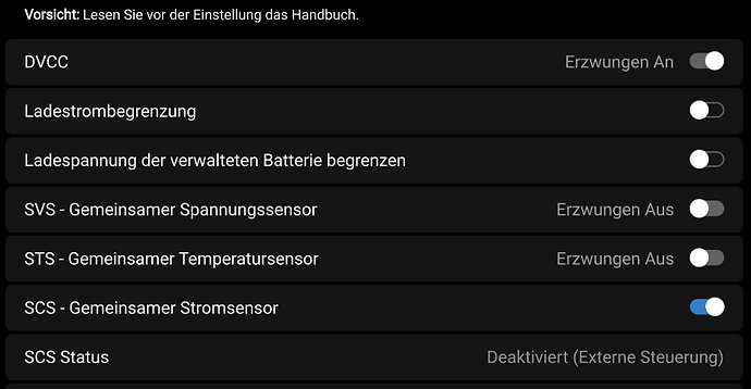

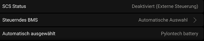

Hello Jeroen,
do you mean this setting?
This is how it was set up back then by the solar company, which is no longer in business.
Best regards,
Nico

First, check which charging voltage the BMS is sending to the Cerbo (CVL). It’s probably set to the value that also triggers the high-voltage alarm, as was the case with my battery when it left the factory.
Usually, limiting the charging voltage to 51.4V in DVCC should help.
Edit: Corrected the voltage following a valid objection from @dennibu
! He has 15s! Pylontech
Oops.
Correction: 51.4 V
