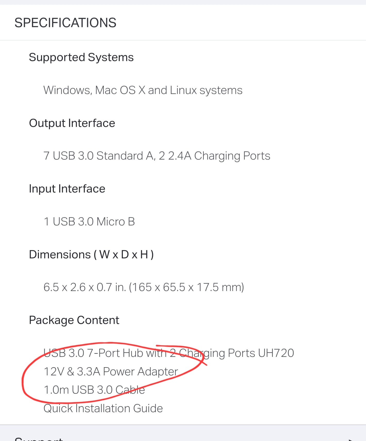

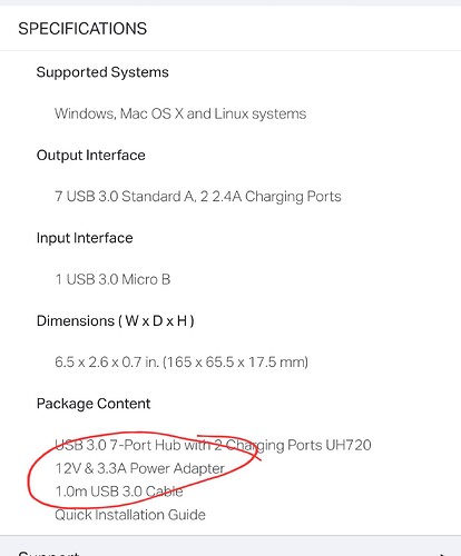

Hi Russell
one that I could power from the 12v battery supply,
Check out the spec, see below. You might be able to.
Dave.
