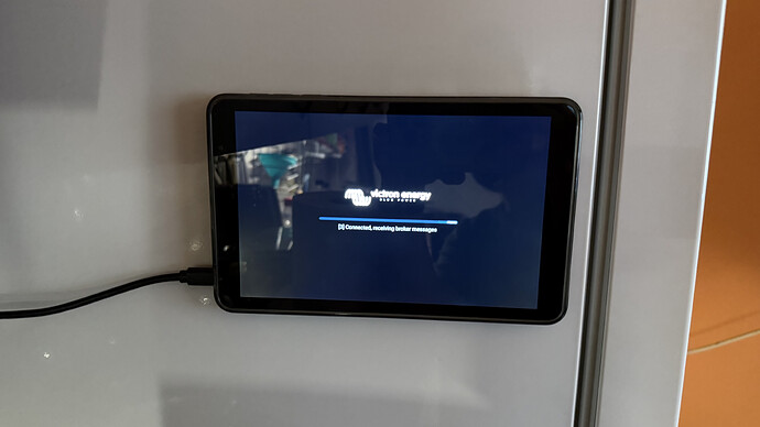

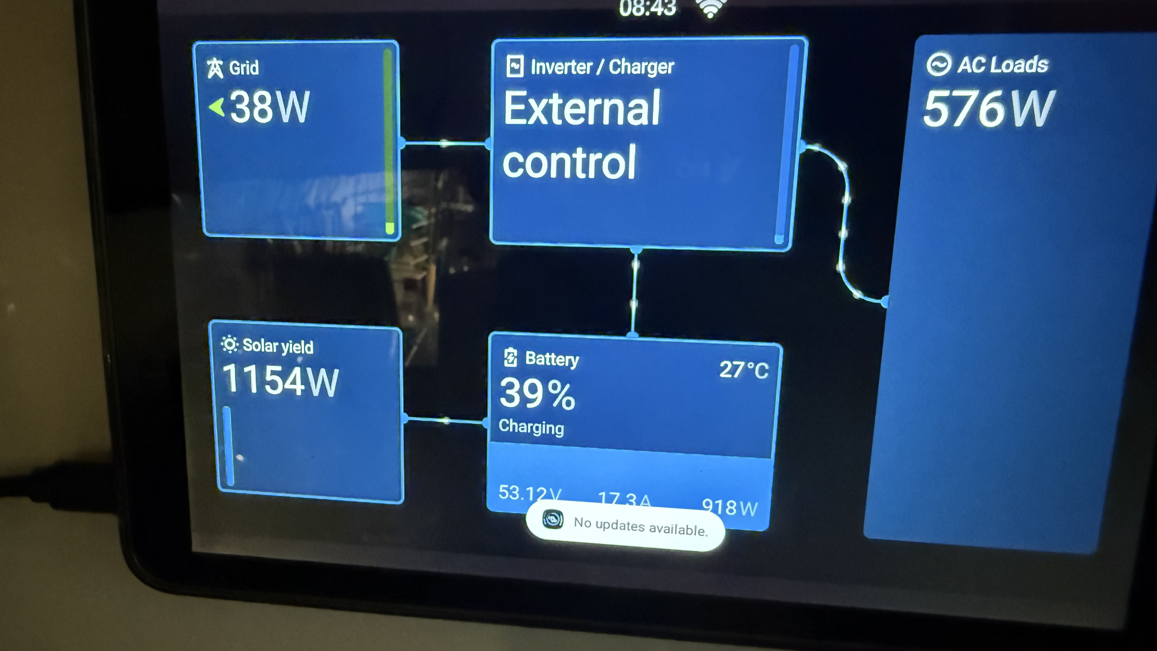

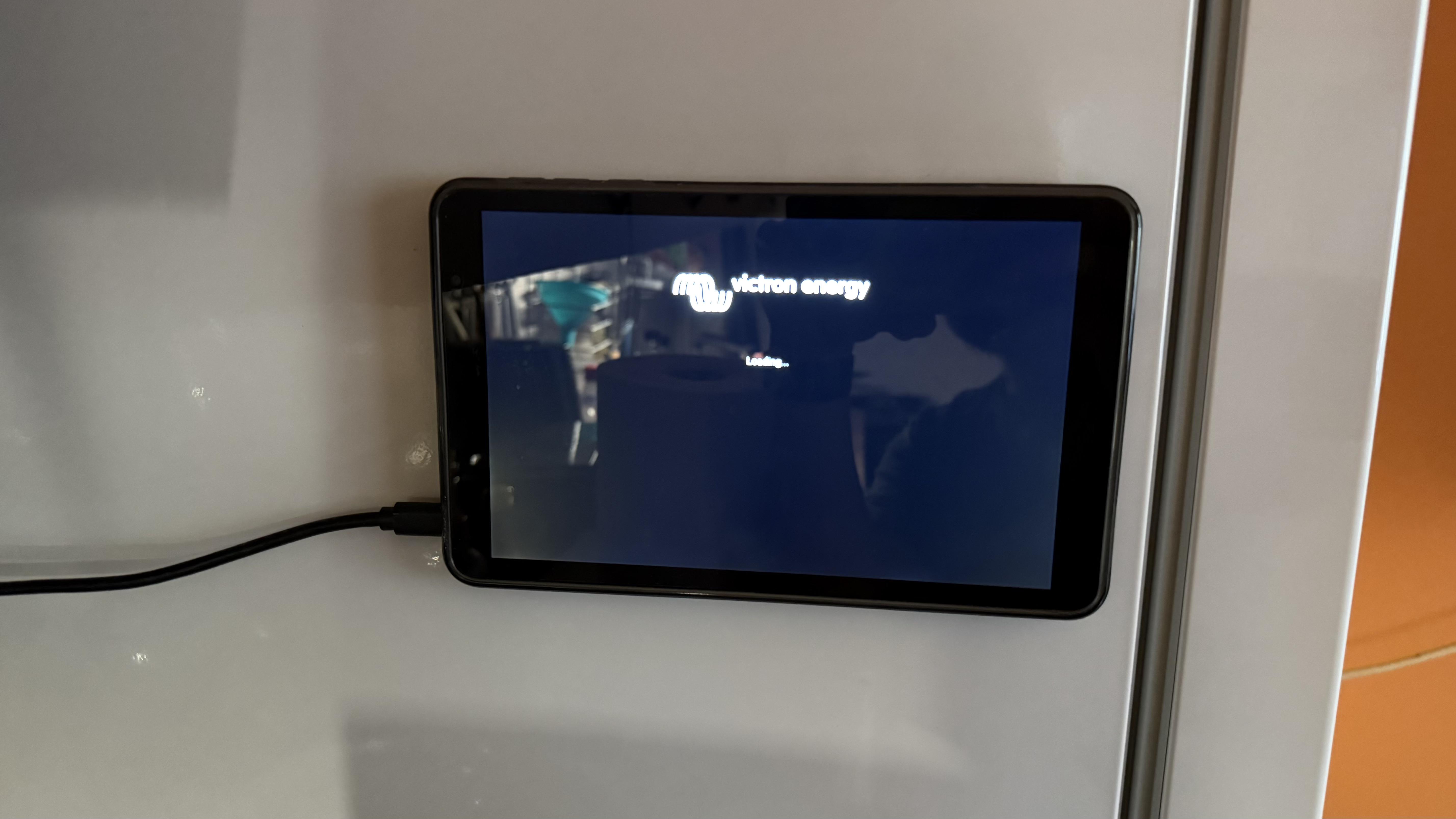

Did you ever resolve this?…..mine is doing the same.
Hi, i cant remember where i saw this but it worked for me!,
Go into the settings and connect to the cerbo gx access point directly
I have a PRITOM 7 inch Tablets Android 13 from amazon i found the easiest way for me was to take a photo of the QR code and zoomin as my tablet camera is poor
once the access point is saved go back in and forget the wifi network previously used
i initially didn’t remove the original wifi and a some point it reconnected to it and the rebooting started up again.
Hope you fine this usfull!
