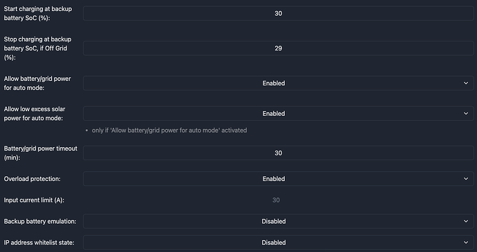

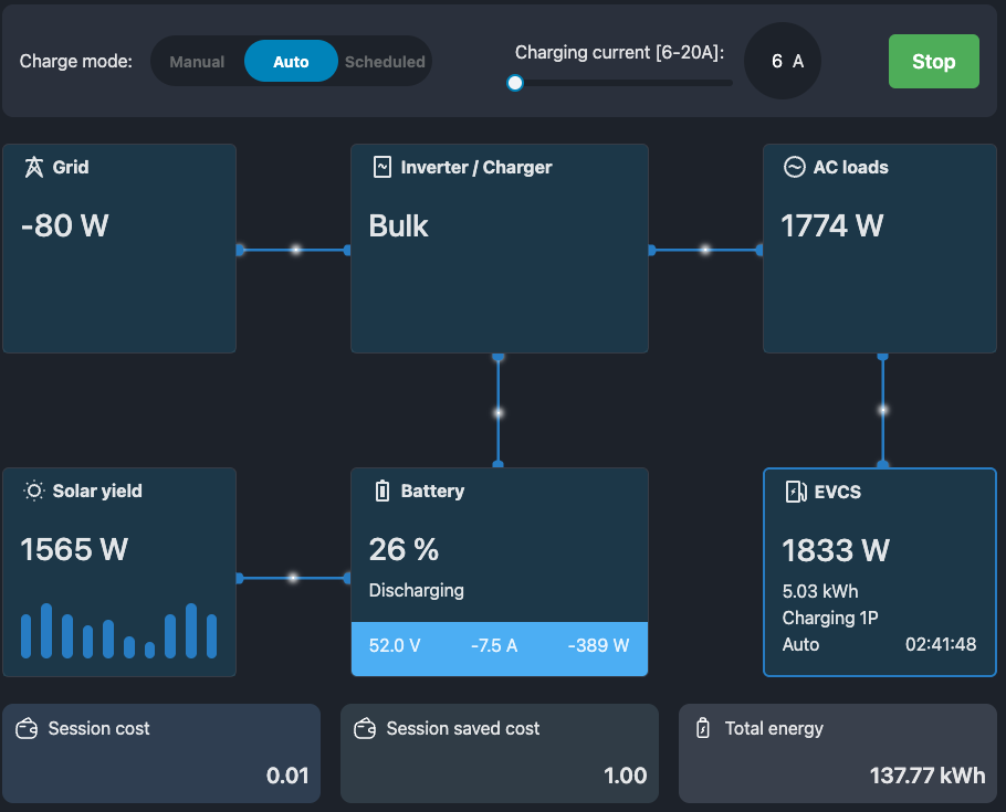

2 - In the evening the auto move stops the car from charge and everything seems to be OK. Then in the morning the the charges sees some production it starts charging ignoring the minimum SoC on the settings.
In todays case, the production started really well but latter some cloud started to appear blocking the production.
The charging should have stop at 29% but it keeps charging without any timer.

Charger:
Charger settings:
