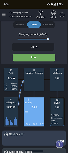

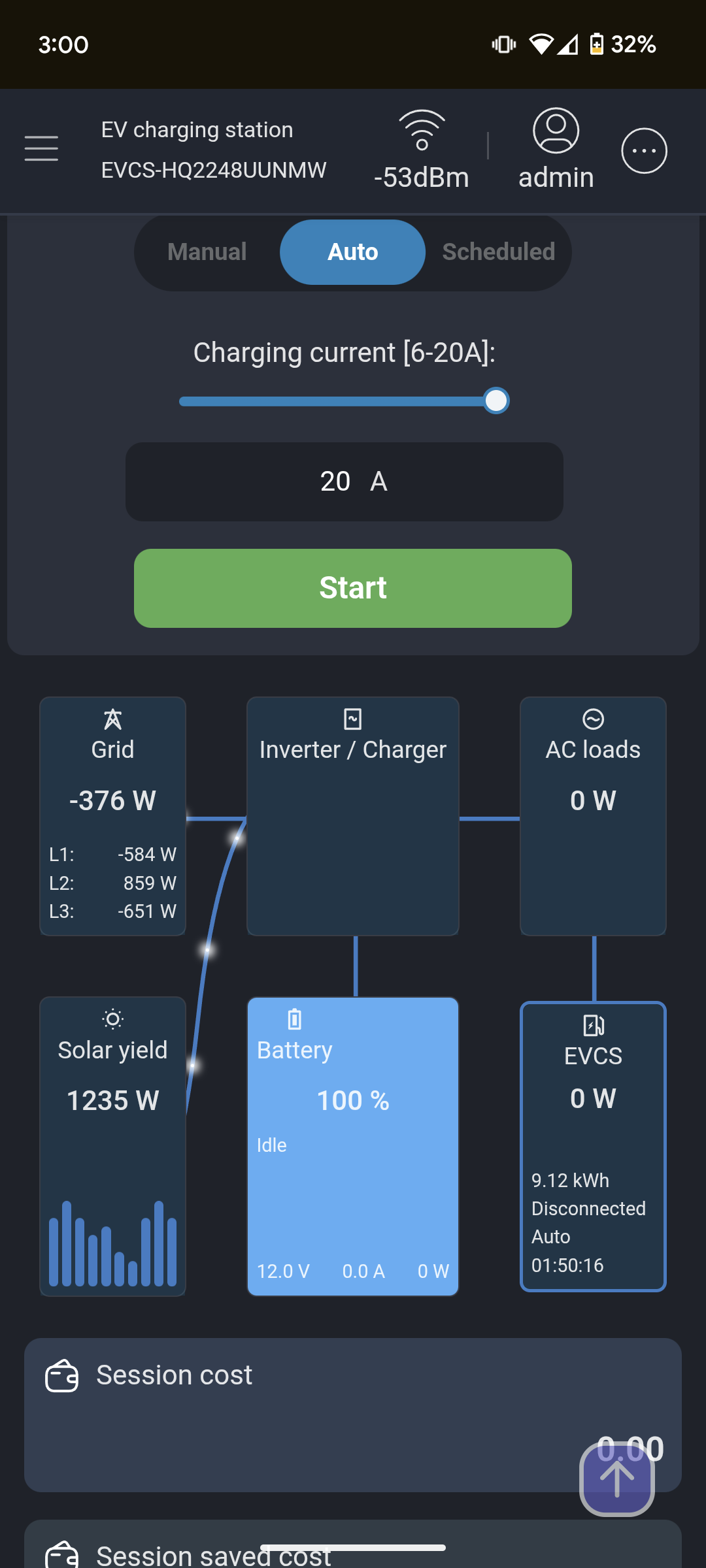

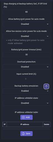

I added 2 screenshots. My settings are correct right?
This was from yesterday, more then enough sun but it keeps “waiting for sun”.

Are your EV charging by 3 phase? If so, min power should be (6A*230V)*3 = 4140W. Can you check also min charging current on settings->general page->minimum charging current.
I think so, yes. But minimum is 6A, doest that mean it’s ~1350W?
6A for one phase. Current EVCS can’t control how many phases are used for EV charging. EVCS provides power for all 3 phases and it is up to your EV(or conenction cable) to decide how many phases to use. So, if your EV uses 1 phase then ~1 380W will be enough for start charging in Auto mode. If 3 phase ~4 140W.
So, you can test it if you will disconnect and then connect EV cable back. EVCS should start charging and will determine how many phases used for EV charging.
