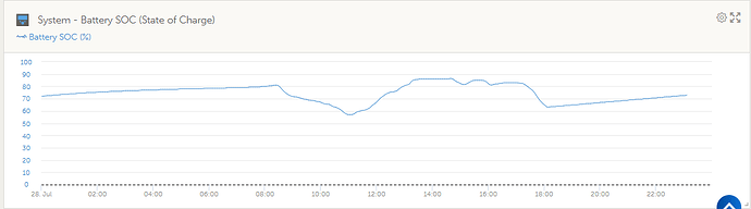

However, at the end of the day’s sunshine, when the battery would normally discharge into the load, with the SOC at about 63% at about 6 pm the battery starts charging from the grid at a steady 12 amps until the battery is at 80% the next morning at 08H20 when the MPPTs start to be come active.

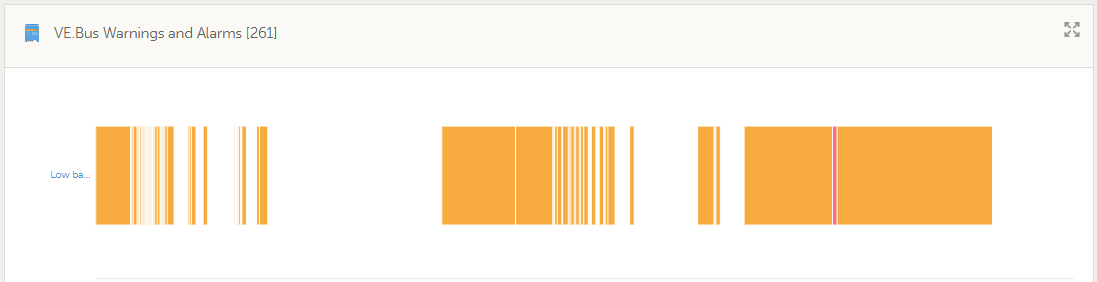

Curiously, during this whole period after 4pm, the “low battery” VE.Bus warning is active. I have scrutinised all of the VEconfigure settings for something out of place but I cannot find anything.

Its usually the ESS dynamic cut off values that make the ve bus warning.
