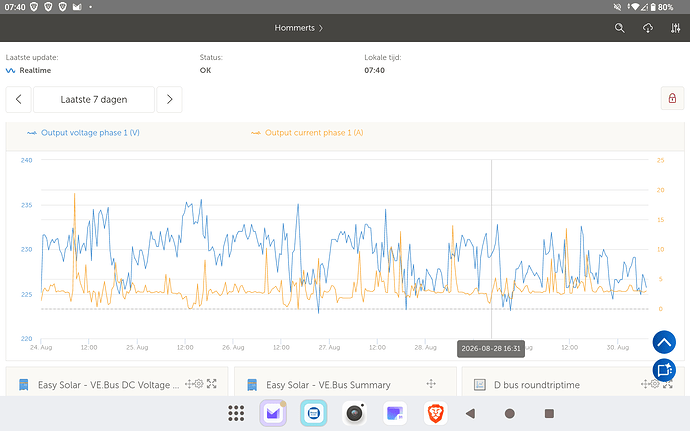

On several occasions now, but only at night, the output voltage from my EasySolar has dropped out for a few minutes. (I know this because the occupant of our garden cottage, who uses an apnoea machine, notices it very clearly :grin:, but also because this causes the RCD in our own house to trip, and when I get up in the morning everything is off.) When I look at the graphs in the “advanced” view, there is no interruption visible around those times. There are no alarm notifications either, which you would expect. Can anyone shed any light on this?

What is the reporting interval for VRM set to on your GX?
VRM charts, set to one minute, are good enough for sustained variation in metrics, but not transients.
If you are really having a voltage drop for minutes, then it would show, unless your interval is much longer - like 15 minutes.
It was indeed still set to 15 minutes. It’s now set to 1 minute.
