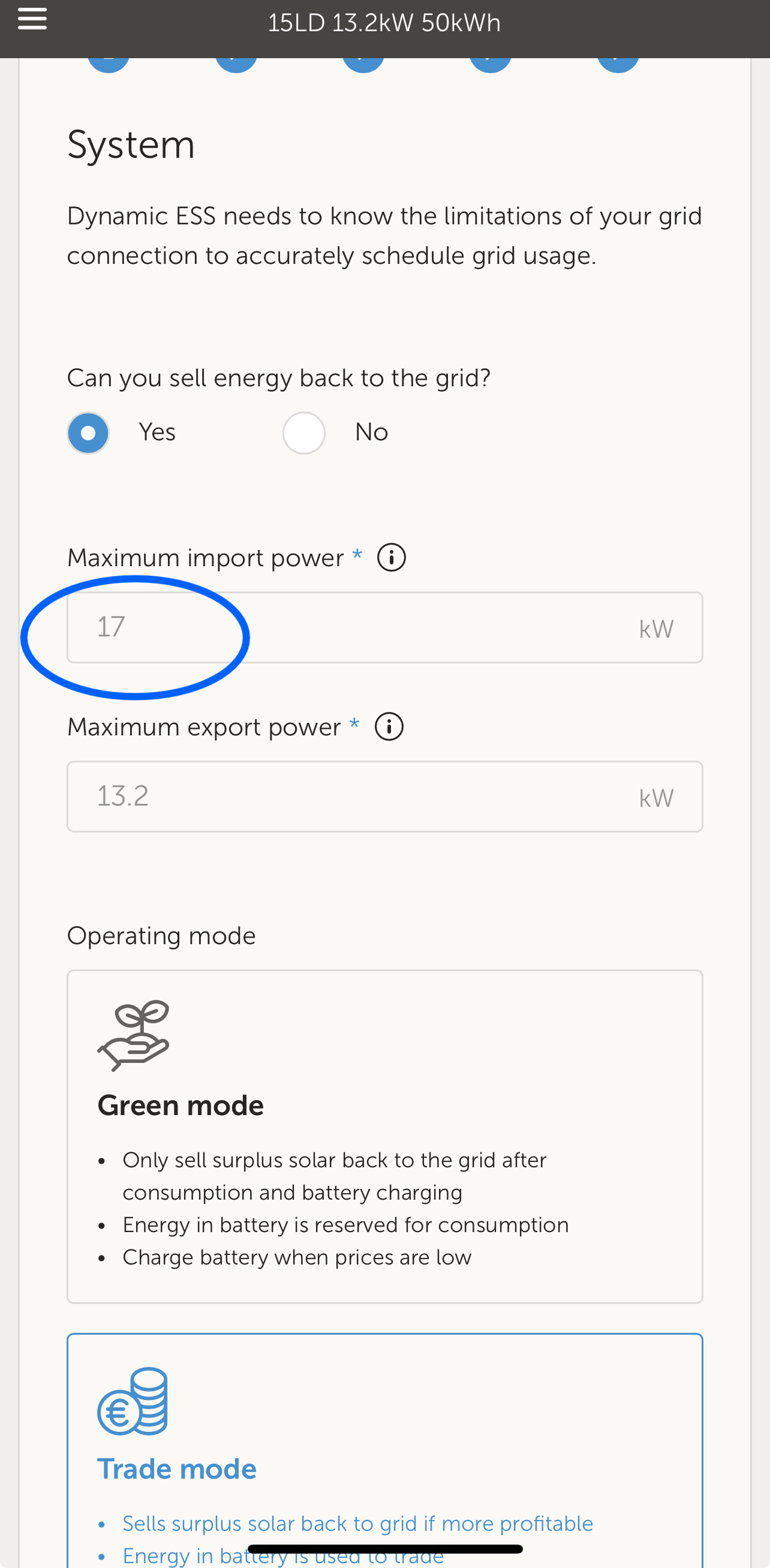

Hi,
Just providing some feedback on my experience with DESS,
The grid setpoint seems to be ignored, I’ve configured the maximum import to 17kW but noticed the system would happily sustain over 21kW, luckily didn’t blow the fuse this time
screenshots
Also noticing energy being imported at the peak rates normally after the energy prices are being published I suspect some last minute changes to optimise the schedule but not absolutely necessary as enough energy was available in the battery to last until next cheaper slot
screenshots
Installation ID d4124390b410
Big thank you to Victron team for the great work you’re doing
@George Thanks for being one of the early UK adopters. :slight_smile:
Note that in the dynamic ESS settings, you are setting the capabilities, not actually setting limits for the system to use. See here for info on setting limits for the system.
I’ll dig deeper into why the system did that extra charge at the peak rate. That shouldn’t happen.
