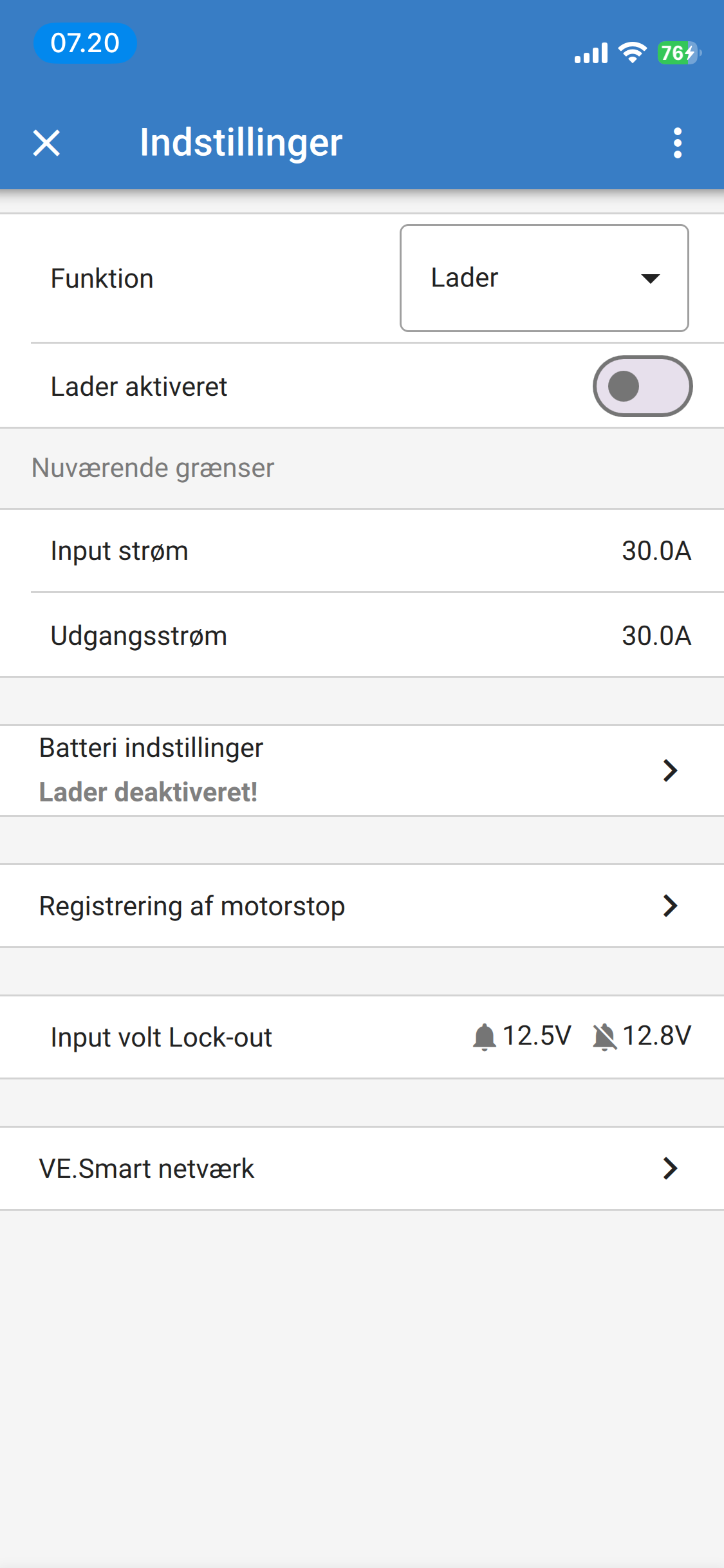

I have this setup in my campervan, but it shuts down the charge all the time, if I turn off one of them, everything works perfectly.
Same setup on both Orion XS

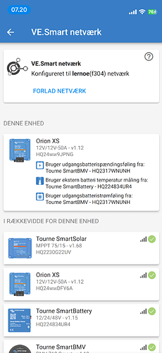

I would try first to delete the VE.Smart Network and let the ORION’s run with there own Voltage measurement.
Greetings from Germany
Summiteer
Sometimes having VE Direct cables connected to a GX device and a VE Smart Network at the same time can cause erratic behaviour. The recommendation is to remove the VE Smart Network and see if that solves the problem.
Hi Summiteer
When I only run one XS, no problem, but when both are powered up and set up the same way they shut down.
I will try deleting them from the VE.Smart network

1 XS with 50 in and 50 out, works
This morning I tried this on both at the same time and it worked
In 30 (60)
Out 20 (40)
This doesn’t work on both at the same time
In 40 (80)
Out 30 (60)
I’ll try this later
In 30 (60)
Out 25 (50)
I think the total out shouldn’t exceed 50

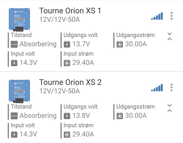

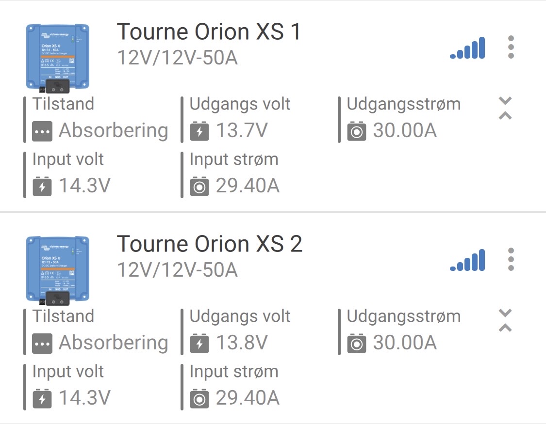

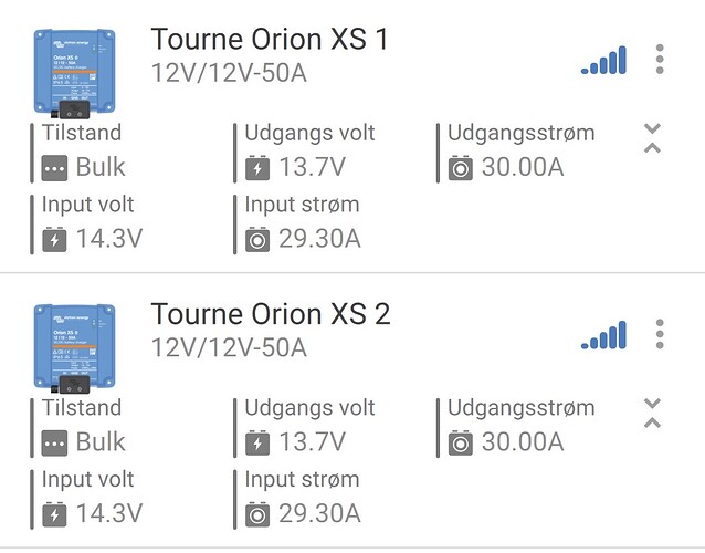

Hi Claus,

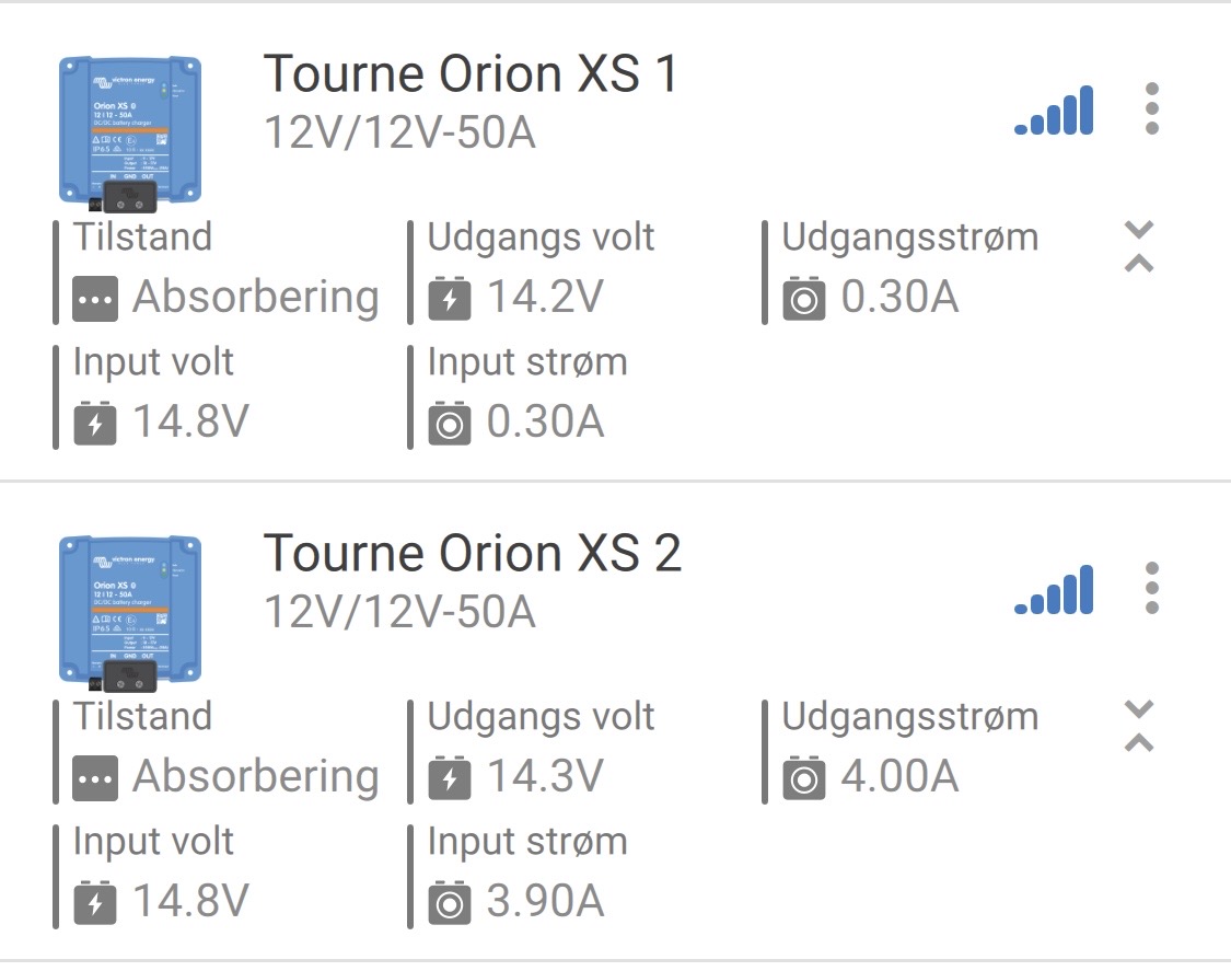

but everything looks ok now. Both XS are charing in Bulk with 30A up to 14.2V and going into Abs.
Your Input Voltage steps up from 14.3 to 14.8 because of the Abs mode and the lower current. So next step would be trying the same with max. current 2x50A. ![]()
