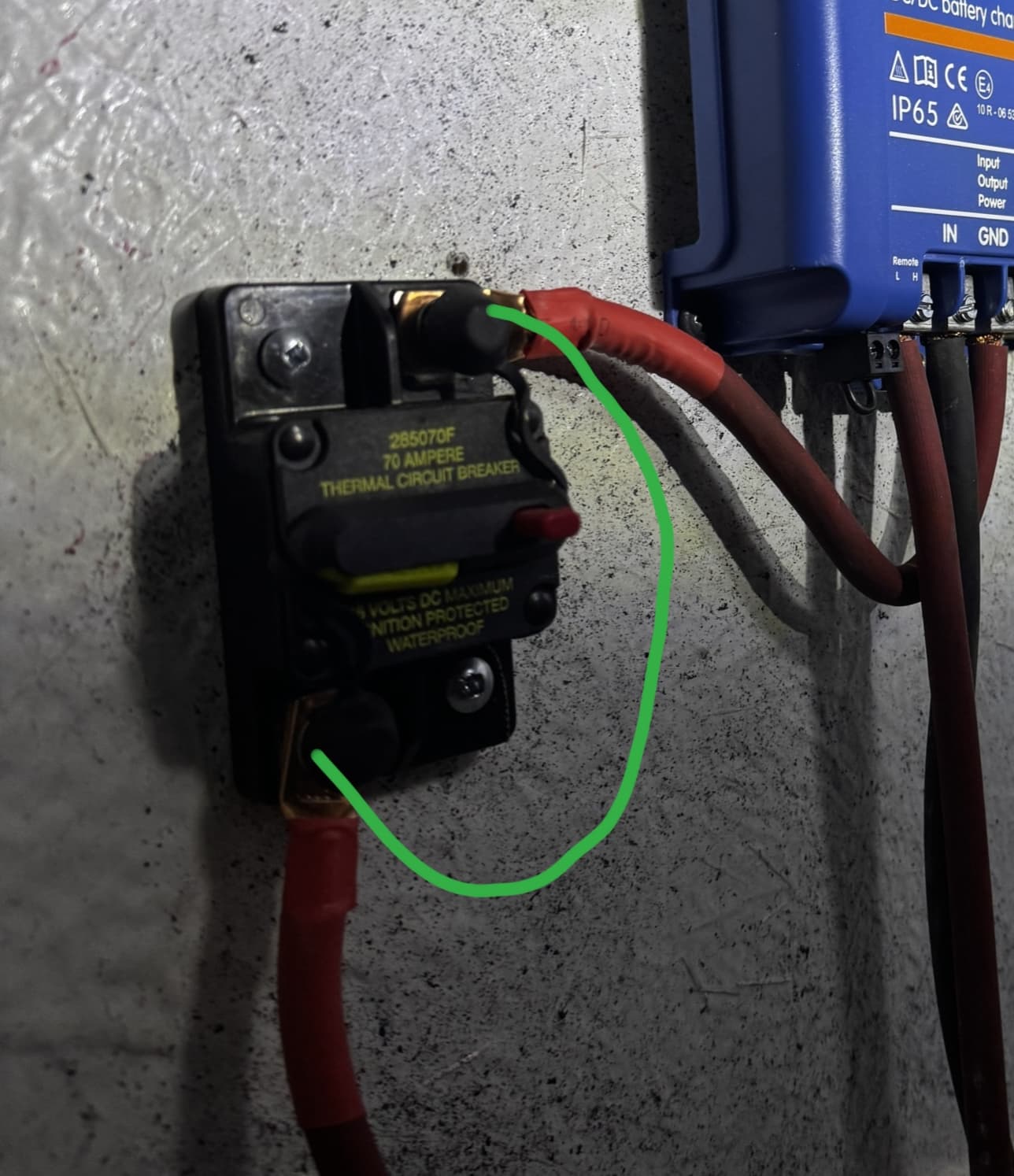

Thanks Mathius. It just seems like there’s a jumper at the plug-in location for The VE direct cable. Attached are five photos. Two of the Victron XS and the three screens from the software. You’ll see that I’ve made some significant modifications in the control app, as this is the only way I can get anything more than 19 or 20 A of charge back to my battery bank. Stuff that I’m reading online makes me think that there’s some kind of a conflict with the smart alternator. This is a 2024 Ford F550. Two batteries, two alternators. I sure would be thrilled if I could get this thing working the way supposed to with a 50 amp input to my battery bank when I’m driving. I’ve also read in a couple of places that were rather than connecting to my truck battery negative terminal, I should go directly to the frame. I haven’t tried that yet.

You should remove that breaker and replace it with a normal Mega or midi fuse.
Those breakers tend to have a high internal resistance and cause problems.

For testing you could also connect the wires at the breaker together.

I’ve ordered the fuse and fuse holder you suggested, Ludo and can install/do more work in a day or three (more on that in a moment) but out of curiosity, I ran my ohm meter across that circuit breaker and had no resistance. But it’s a cheap quick swap out so why not?

I’ll replace the fusing in a couple of days, but I’m not optimistic, given I saw no resistance across the breaker.

I’ll get the new fuse and fuse block tomorrow Not really convinced that there is any real resistance across the current breaker. My understanding is Victron commonly recommends this breaker.

Thanks Ludo. I checked that breaker while charging at about 30 amps from the Victron. It was cool to touch. As was the XS. No lose connections. It has 0ohms resistance on my multimeter. Does it still make any sense to swap it out? Or should we be pursuing other potential pathways?
As I wrote above you could bridge the breaker for testing.
Connected the two wires together on one connection.
