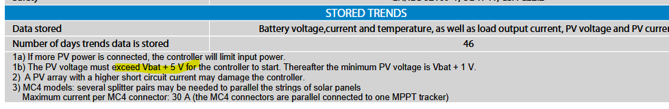

It needs a minimum voltage vbatt +5v as fredvduin has shown from the datasheet.

Minimum voltage Vbat + 5Volt
What you may find in the morning with your battery depleted is that the battery is at say 12V and your panels can generate the required 17V to get started. Once started they have to stay 1V higher than the battery to keep working. When you disconnect them and try and restart later in the day, the battery will be at a higher voltage and may well retain surface charge for a while so it may be at 13.5V or 14.0V and the panels can not then generate the required 18.5V or 19.0V to restart.
