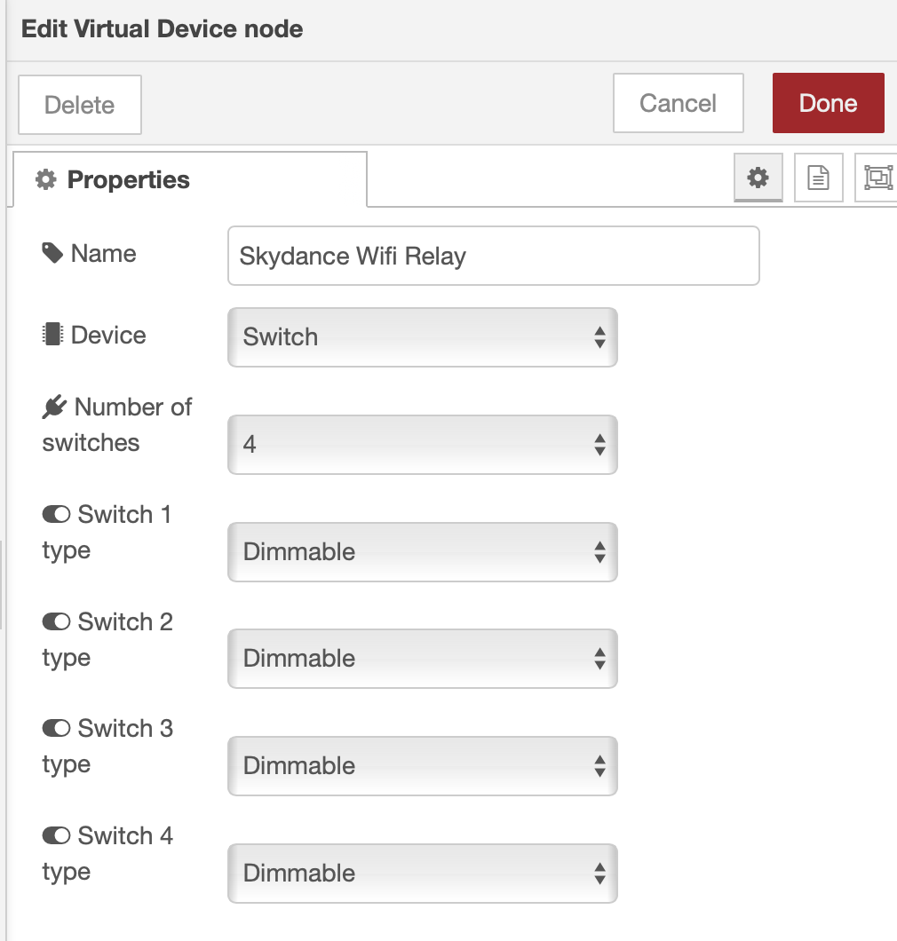

I have added a “Virtual Device” in Node-Red and I have selected “Switch” as the Device.
I have configure them as “Dimmable”

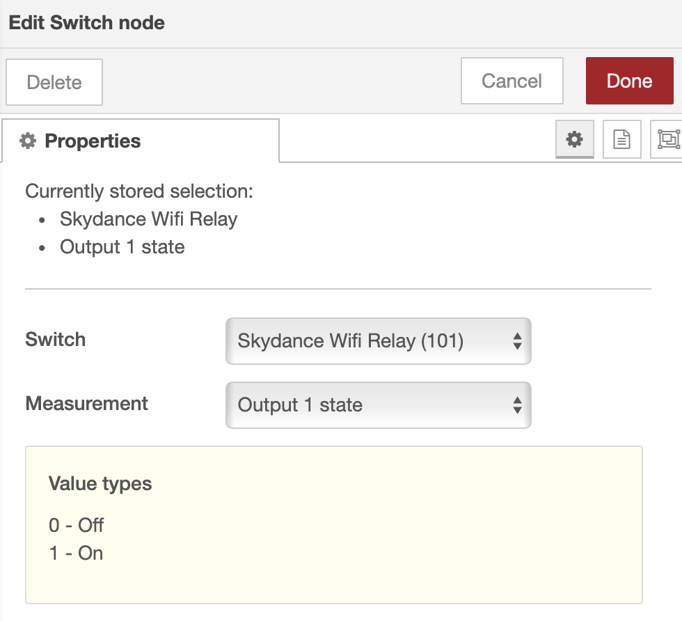

Once deployed, the “Dimmable Switches” appears in the VenusOS interface.
I have also added a “Switch node” to receive the value in Node-Red (there is only Output state)
When I press On/Off, I received 0 or 1 as a msg.payload.
However, is there a way to receive the value of the Dimmable ? (like between 0 to 100 or 0 to 255) ?

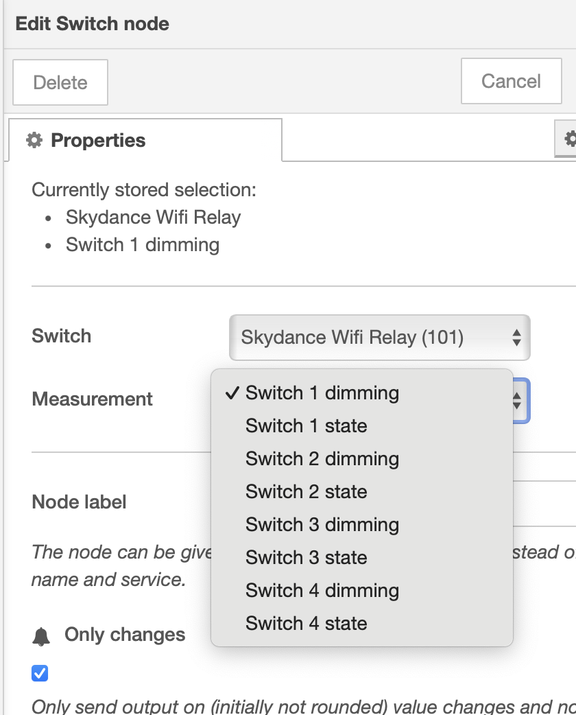

I am currently testing with 3.70~13
The dimming is now available:
