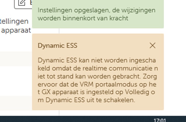

Since yesterday, I’ve been trying to adjust the battery capacity in the DESS settings, but I keep getting a communication error. I already checked in the GX, and the communication there is set to Full “Volledig”. Any changes I make in DESS are not applied, while all other communication works fine.
Both BETA 3.70~35 and BETA 3.70~40 show the same message. I don’t believe it’s caused by the BETA.
It concerns a single Multi RS Solar.

For my system, I’m seeing the same message, despite settings are saved as they should.

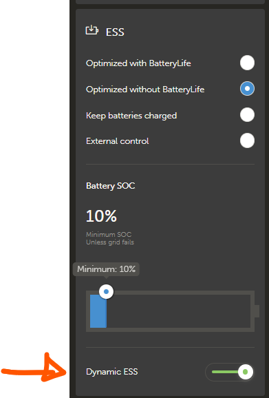

Verify, you turned DESS on in the drop down menu as well:
Thank you for the quick response!
DESS is enabled. I just tried again and waited for 20 minutes, but the capacity did not adjust.
