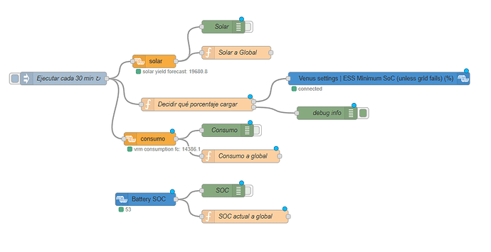

Thanks, I will take a look; now it is easy to automate it in node-RED with a function with your particular case, with the help of AI. Yesterday I was working on it; there is an evaluation at 4:00 on night to charge the battery setting the neccesary SOC for 3 hours with the consumption and solar forecasts, and actual battery, and during the day it reevaluates every half hour if it is convenient to do little additional charges on cheap hours.
I will test it through the next months, adjusting if neccesary.
Technical summary:
This system uses Node-RED to implement a predictive control strategy for a Victron Multiplus II ESS, with the goal of minimizing grid energy costs.

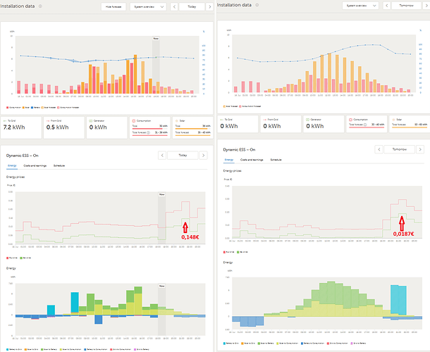

Today is similar situation (like it was yesterday) that it could sell evening but has decided not to, even tomorrow clearly shows that it will be full.
Yesterday it did not sell evening and sold in the next morning with 3x less price.
Will copy screenshot here so I can compare it tomorrw :slight_smile:
Actually I’m ok when DESS does not sell in the evening, but I’m against when DESS decides instead to sell in the morning with 3x less price.

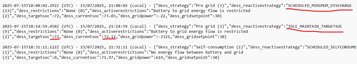

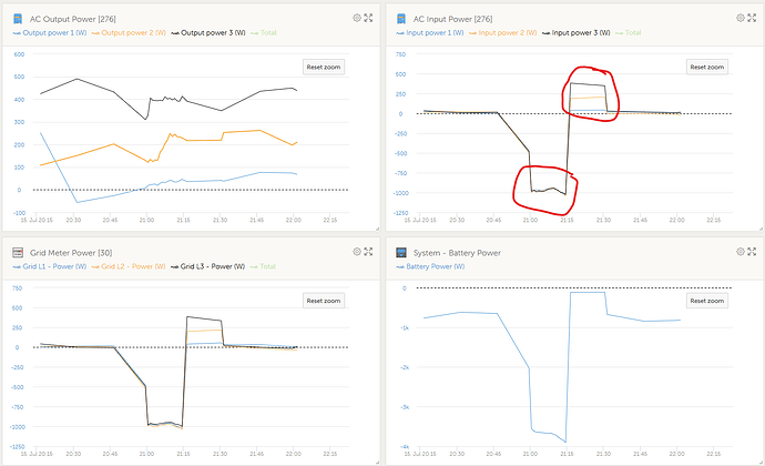

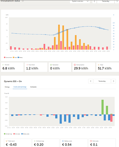

21 → 22 is over and yet again DESS acted weirdly
  1. It sold from 21:00 → 21:15 with 3kw power
  2. then from 21:15 → 21:30 it covered load from grid around 600w
  3. and from 21:30 it went to self consumption
Can’t understand why that sell for 15 minutes was nessesary with 3kw when it then bought next 15 minutes energy back with 600w???
So it sold for 0,1€ and then bought back energy for 0,05€ (why DESS … WHY)

And as I thought DESS decided to sell in today morning low prices instead of yesterday evening high prices :frowning: And my battery cost is 0,03€ but it still sold with 0,021€ price at 6AM.
So I have to turn DESS off because it is just wasting energy (and I’m in Green Mode)

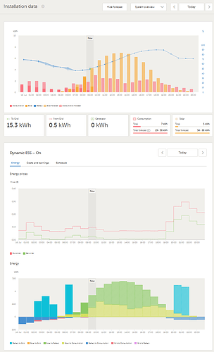

I’m not doing the scheduling, what I would assume here:

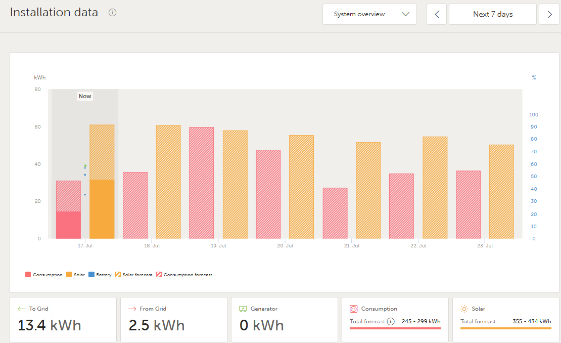

  • Consumption was forecastet high at 1,2,3 (System Overview Graph shows that even for passed hours)
  • So the system kept the energy in the battery to support “this” expected consumption.
  • That consumption didn’t happen, so it decided to sell to grid instead, to empty the battery for the upcoming morning hours.
I always say: Looking back at “happened” things and determine that wasn’t ideal is “easy” - but looking ahead and predicting what would be ideal is the tricky part.
If consumption would have happened as predicted, that plan would have been absolutely okay. But consumption was lower than predicted, so kinda Plan B was used to sell at somewhat ok prices before morning solar kicks in.
But that’s how green mode should work: Focus on cover own consumption, then just sell “at best prices” what’s left over.
You should rephrase that: There was no energy “wasted”, There was just “less” optimized profit than there could have been. Never the less still more than with DESS disabled - where you would have entered the morning on probably 70% Soc, leaving only 30% room to charge solar during unfavourable sell-price-hours.

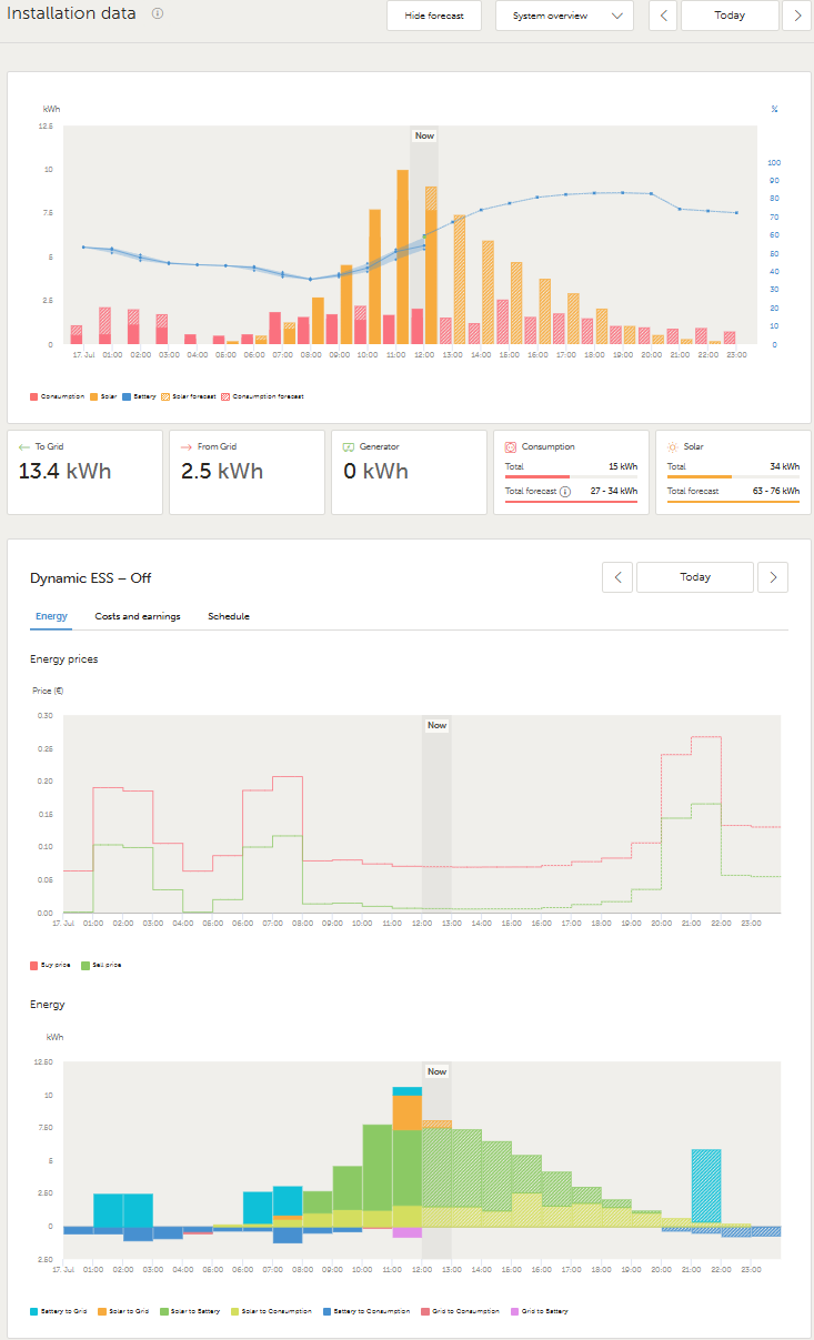

What brothers me most is that I can’t trust DESS plan at all.
Today morning I looket it and saw that selfconsumption pv to battery and evening sell from battery.

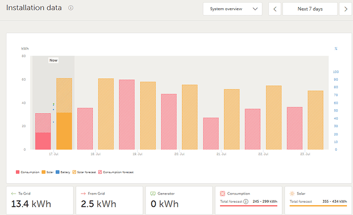

But then at 12:24 I saw that DESS is buying from grid with 6kw of power. That is strange because 7 day forecast is showing more pv than consumption
Here is what DESS did out of the blue and I have " Yes, enable charge* battery from grid restrictions" in weekdays from 7 to 22 Yes, so it ignored that.
Here is todays details, where you see that selling price is basically 0€

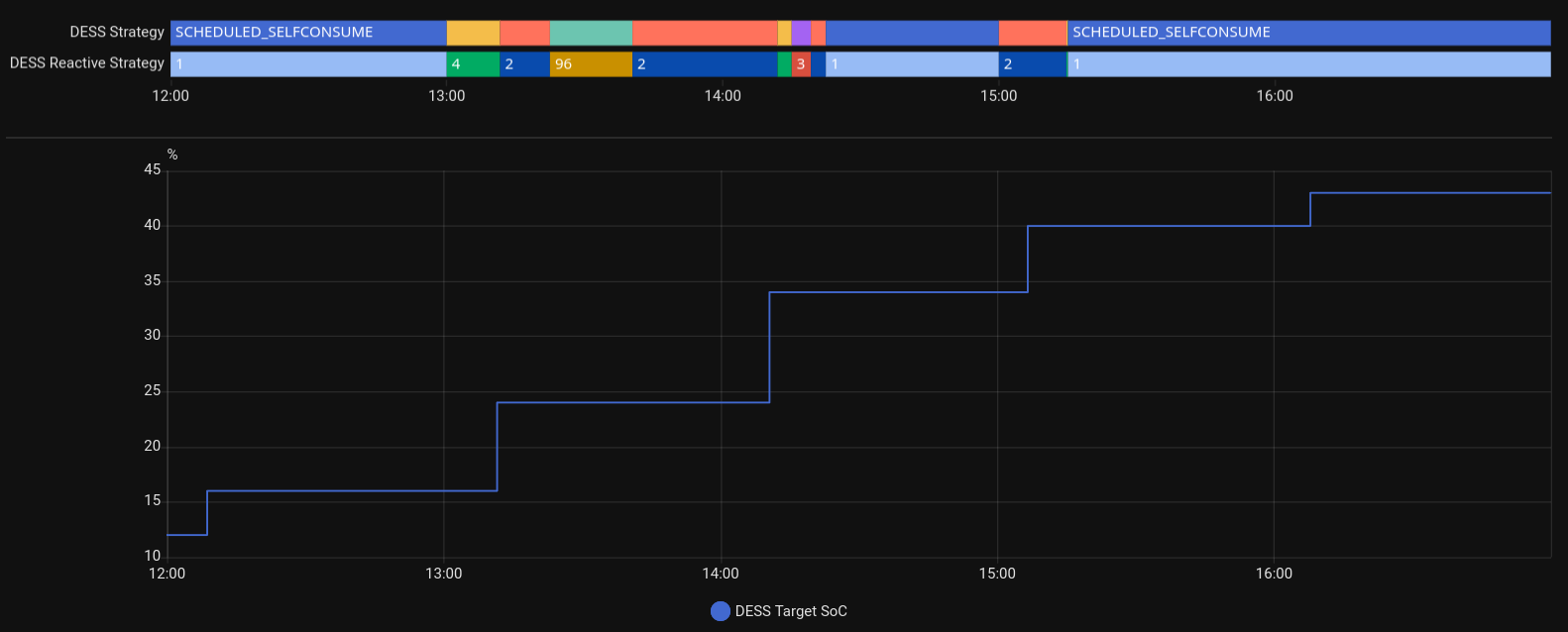

And here is log i’m recording about DESS.
interesting, how do you record those DESS logs?

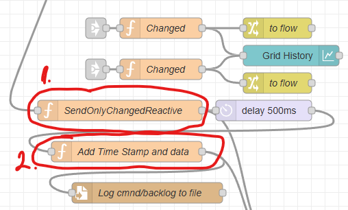

I have custom function node in node-red that is gathering all this data from flow and when “dess_reactivestrategy” changes is writing it to text file. Then I can afterwards understand what was these values when reactivestrategy changed.
nice! would you care to share the flow?
There is so many interconnected parts in that big DESS flow of my, so copyng it all here is pointless.
The info if feed in to first function node from:
com.victronenergy.system (0)
/DynamicEss/ReactiveStrategy
There is also change node that is changing topic to “Reactive”
First function that insures only changes are sent:

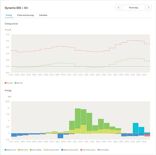

Not using any customs flows or HomeAssistant overrides, I can say that 15min pricing works pretty well with DESS!
Top graph: electricity price
Bottom graph: yellow = grid power in, blue = battery power in
(Dont be confused by that oscillation on the right - it’s caused by a switching load (electric oven))
The only gotcha you may run into is that VRM will not show forecasts and schedules on a 15min grid but 60mins. But in practice it’s running at 15min intervals as you can see in above where it’s charging from grid for a 15min period and also in the following graph where the strategy changes in 15min intervals:
Only the current DESS target SoC looks quite odd to me, it’s taken from venus/N/xxxxxxxxxxx/settings/0/Settings/DynamicEss/Schedule/0/Soc and looking into the future, the succeeding target SoCs (Schedule/1/SoC, etc) are the same until 1h later where it jumps.
