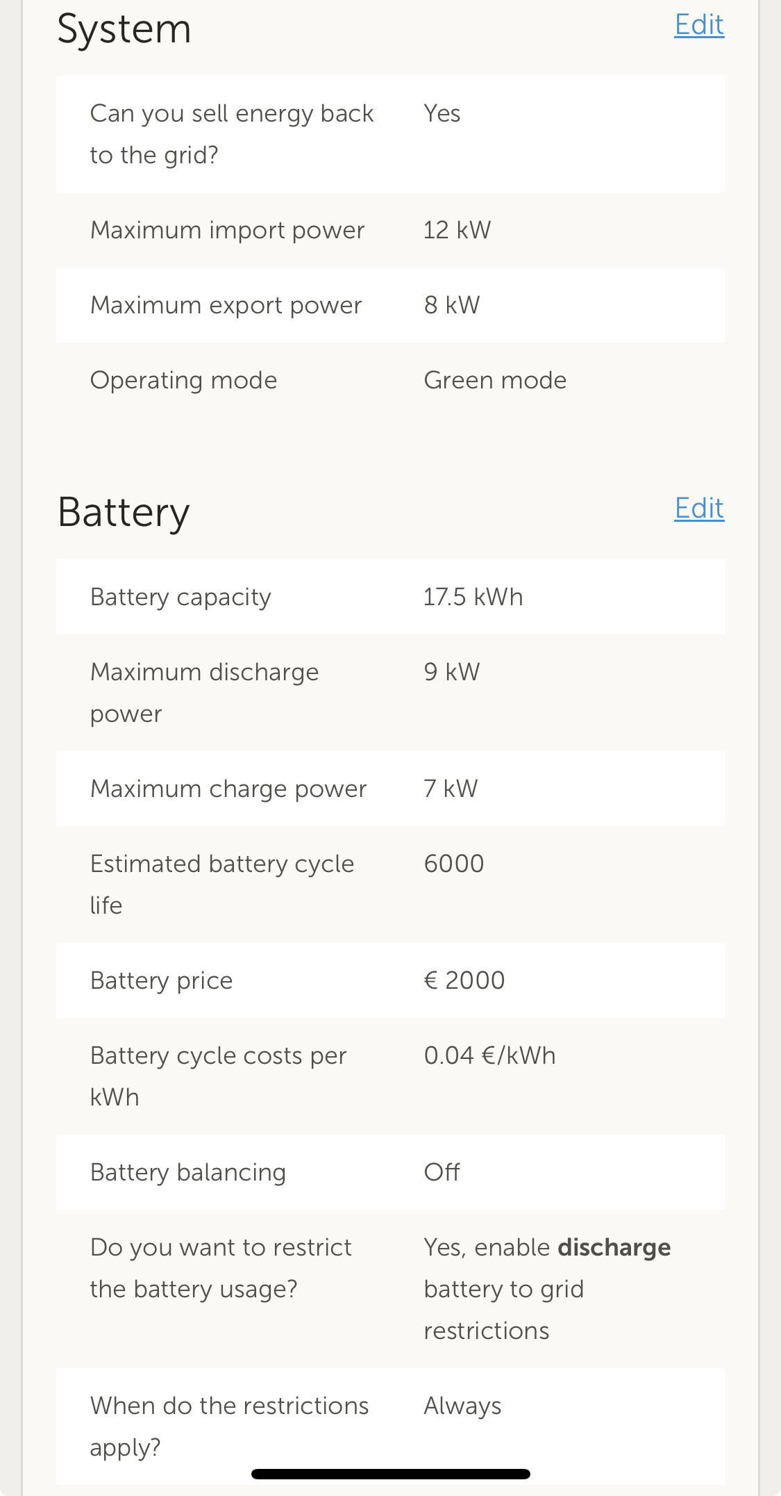

I have set maximum charge power from 9 to 7kw but problem is the same.
Here my actual settings
System is 3x5000 with 17.5 kw pylontech battery
