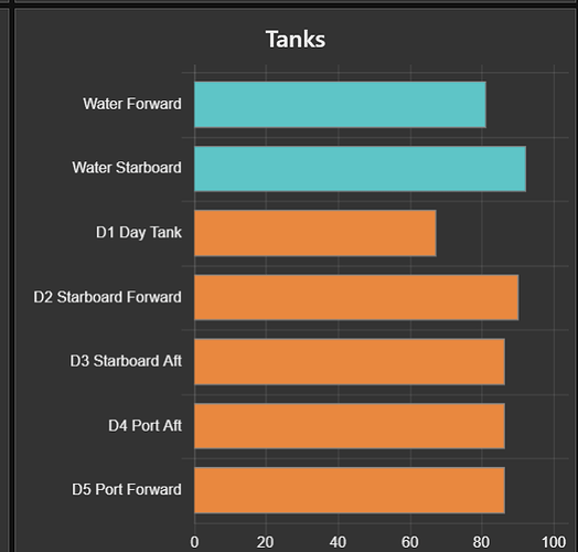

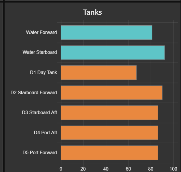

This is a bar chart with seven tank sensor input.
Copied the same flow and just changed from Dashboard 2.0 nodes to the earlier version.
No issues now so, something not quite right with DB2/Venus OS.
