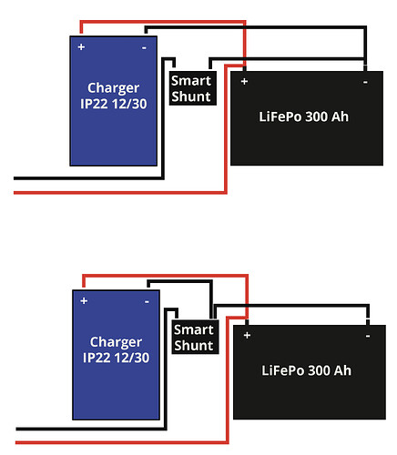

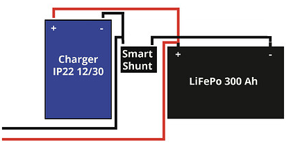

I am in search of the correct wiring of the negative cable from my ip22 12v/30 charger to the lifepo battery.
Does the negative have to go directly to the negative pole of the battery (as on top) or through the smart shunt?
Or doesn’t it make a difference at all, as negative is negative?
Thanks in advance.

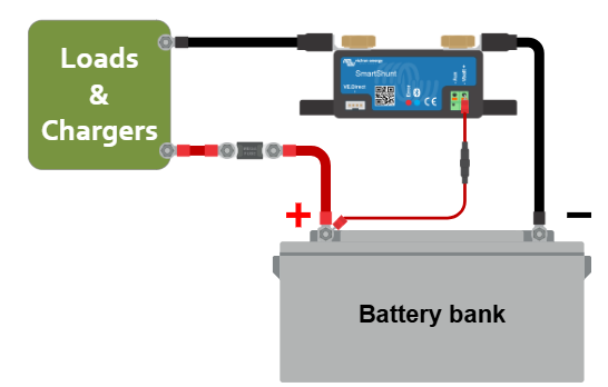

RTFM
wow that was quick. I’ll try this. Thanks a lot!
