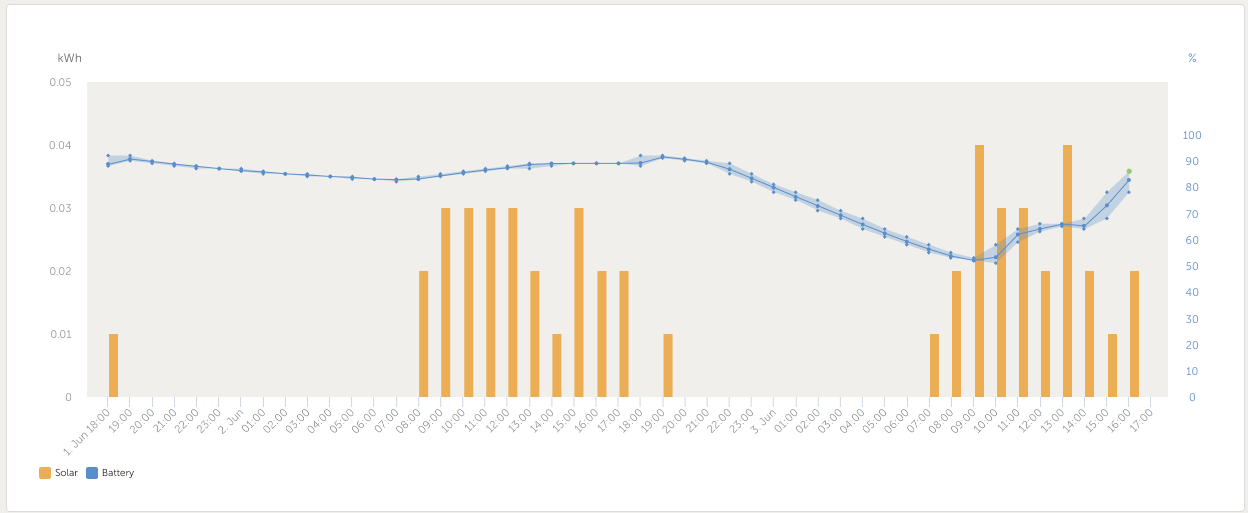

I would also like to see better visualization of the data in VRM on DC only systems… as with the DVCC, you don’t get the red consumption bars in the graph if you don’t install SmartShunt.
And now with Orion XS having VE.Direct, it would also be nice to see Alternator energy bars - similar to green Generator energy bars with AC system.
Now the graph is rather poor, no consumption or alternator, just solar and battery
