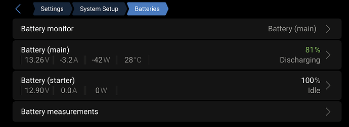

Hello ! I think, indeed, in your use case, as well as in mine, that idea to modify that logic in DVCC of “DC loads” calculation will work. May be not so precise and not always stable, but at least better than without it. Exactly, your Orion is limiting himself to 10A total supplied current after the BMS orders to limit charging current to 10A. Instead, it should be ordered to change the DVCC’s “max charging current” to 10A and then, DVCC should account for loads consumption and demand from Orion+solar charger to give total current enough to cover the loads or as much as they can, at least. And DVCC will do that if we allow him to get DC loads value , if not possible by direct measurement via additional shunt then by calculated value which is also possible, even if not so perfect. I’m hoping we can find out what exactly to change in the code to realize that then we can test. Highly possibly it will work. Just need to find a way.
Another comment I wanted to write about particular your case: Can you try to configure your BMS-can as (to be) the “battery monitor” in your Cerbo ? Or you already did. I thought if the BMS-can will do the same as the smartshunt-as-battery-monitor is doing then the consumption on the graph will be showing, at least, and then the “DC loads” will be possible to calculate via this formula: DC current = (orion’s_Current + bluesolar’s_Current - BMScan_consumption); with the exception if BMS-can’s current is negative then take +(ABS(BMScan_consumption)) instead of minus. And that logic to calculate DC loads is already implemented in DVCC’s code, just need to make it use it for limiting charging current.
Yes… it’s exactly as you are describing.
And Yes, the BMS-Can managed battery is selected as the main battery of the system in Venus OS. The starter battery (lead acid stupid battery) has the SmartShunt set as battery meter but only for information, not used in Venus for anything meaningful besides passive monitoring.
